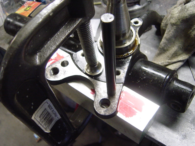

Using a transfer punch to mark the mounting holes in the adaptor so they line up
with the holes in the struts.

craig downs   Using a transfer punch to mark the mounting holes ...   Oct 25 2007, 01:41 AM
