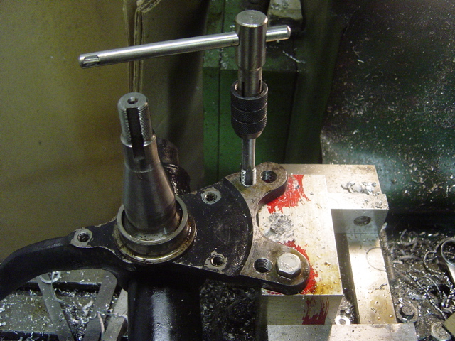

Tapping holes in the struts and checking multiple times with a square to make sure
the threads will be square.

craig downs   I have just finished Aaron's struts and I will...   Oct 25 2007, 01:28 AM
craig downs   Holes drilled   Oct 25 2007, 01:30 AM
craig downs   Since the mounting holes are into the step I had t...   Oct 25 2007, 01:36 AM
craig downs   Using a transfer punch to mark the mounting holes ...   Oct 25 2007, 01:41 AM
craig downs   Tapping holes in the struts and checking multiple ...   Oct 25 2007, 01:51 AM
craig downs   All for now will add more later   Oct 25 2007, 01:54 AM
