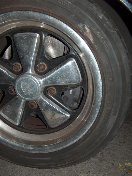

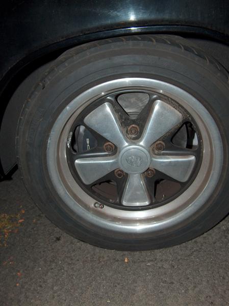

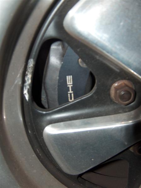

Here is a complete pic (IMG:style_emoticons/default/smile.gif)
Install went great - no surprises (IMG:style_emoticons/default/smile.gif)
some detailed pics will be posted later (IMG:style_emoticons/default/tongue.gif)
