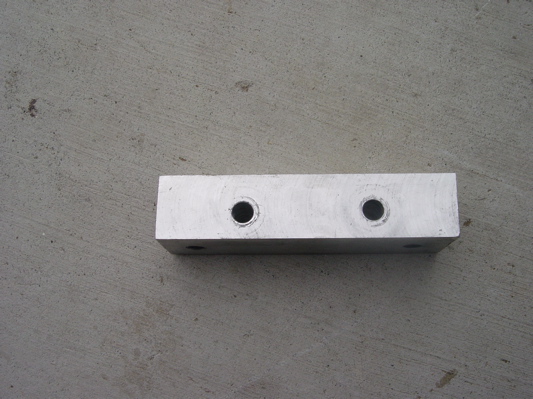

Here is the rest of the machining
The block drilled and tapped to mount on the strut.

craig downs   I have just finished Aaron's struts and I will...   Oct 25 2007, 01:28 AM
craig downs   Holes drilled   Oct 25 2007, 01:30 AM
craig downs   Since the mounting holes are into the step I had t...   Oct 25 2007, 01:36 AM
craig downs   Using a transfer punch to mark the mounting holes ...   Oct 25 2007, 01:41 AM
craig downs   Tapping holes in the struts and checking multiple ...   Oct 25 2007, 01:51 AM
craig downs   All for now will add more later   Oct 25 2007, 01:54 AM

craig downs   Here is the rest of the machining The block drill...   Oct 28 2007, 04:07 PM
craig downs   Oops on the photo above the caliper is centered on...   Oct 28 2007, 04:14 PM
craig downs   Getting ready to drill the mounting holes showing ...   Oct 28 2007, 04:17 PM

craig downs   Drilling the holes Tapping the holes making sure...   Oct 28 2007, 04:20 PM

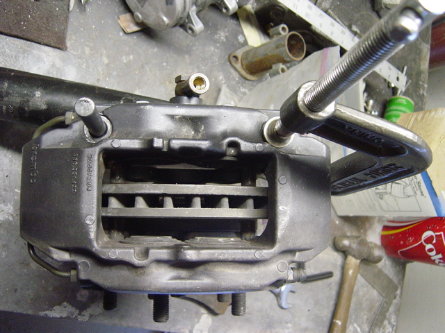

craig downs   Caliper mounted to the strut   Oct 28 2007, 04:22 PM

craig downs   Cutting off a little of the old mounting ears so t...   Oct 28 2007, 04:27 PM
craig downs   Sorry messed up again this is the 1st time I have ...   Oct 28 2007, 04:34 PM
craig downs   Here it is installed in the car   Oct 28 2007, 04:37 PM
