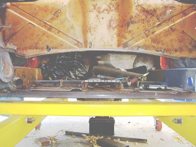

I made my own dedicated bench for 911's and 914's. By some stroke of luck I ended up with a 1 mm variance in height (datum) and 2mm in length and width is zero with my own fixtures. This has been substantiated with endless anal cross measuring and factory manuals. I used a steel front suspension cross member as a front body holding fixture. I went through 4 before I found an acceptable one. The first 3 were so far off factory tolerances (4-6 mm out of square) I rejected them before I found a good one.
My bench is not for pulling. It was designed for assembly and replacement of structural parts. It will support 3,000 pounds. $350 worth of steel and another $175 in industrial castors was worth it considering its use. A stripped 914 shell is a feather and easy to roll around. When you cut and replace structural parts recheck your measurements. Control points change when you remove, replace and weld in new parts. They are easily controlled with patience.
If it does not come out perfect do not lose sleep. Remember tolerance and variance was not perfect from the factory. If you have a control point locating hole that is 14 mm a dowel or pin of 9-10mm was used during birth. That is why suspension systems are adjustable for variance and wear. You will also find center indexing points on the front and rear of the body. Easy tools to use are plumb lines, tape measures and levels if you do not have access to high end measuring equipment. You can locate and make symmetrical measurements throughout repairs. If you have one side that is undamaged or not rusted use that side as a starting point for measurements. Use panel gaps as a visual indicator during repairs and welding.
3 important factors- height, length and width. If you are me then there are 4 (Z axis) and that one will make you lose sleep!

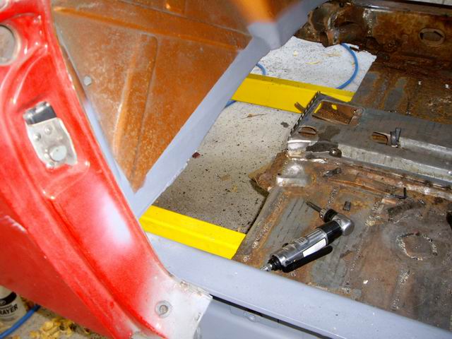

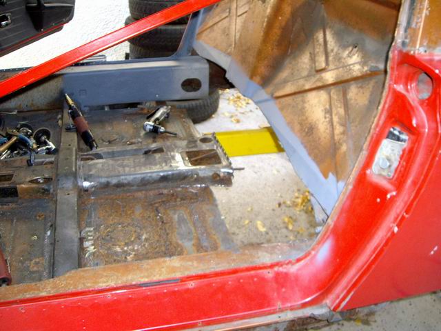

Didnt get anything done for two weeks. Fire's, house stuff and other distractions took over.
Had a nice solid 4 hours to play today.
Cut and trimmed the remainder of the old panels, flanges and junk out.

Jeff Hail   Moving along into the rocker and longs. This was h...   Oct 2 2007, 12:08 AM
Jeff Hail   Cut out the rusted outer. Actually only the rear 1...   Oct 2 2007, 12:17 AM
Jeff Hail   Floor metal finished and primed. No filler. I did ...   Oct 2 2007, 12:54 AM
