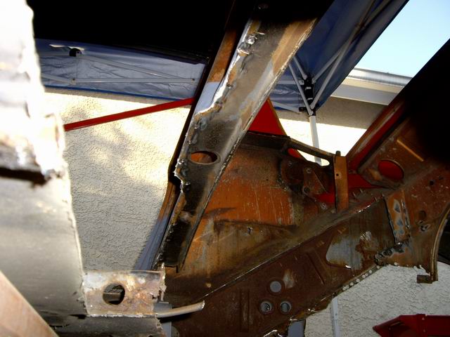

Some pics of the beggining: A back east 914 comes to California.

Prepped the flanges and seams for the inner and outer firewalls.

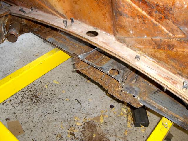

Jeff Hail   Moving along into the rocker and longs. This was h...   Oct 2 2007, 12:08 AM
Jeff Hail   Cut out the rusted outer. Actually only the rear 1...   Oct 2 2007, 12:17 AM
Jeff Hail   Floor metal finished and primed. No filler. I did ...   Oct 2 2007, 12:54 AM
