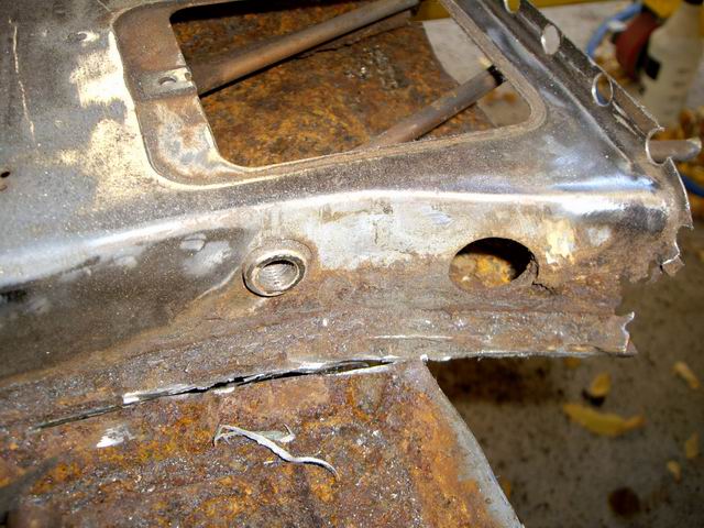

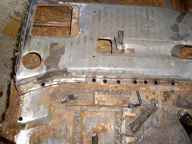

Passenger side of the tunnel was just surface rust and came right off with a conditioning pad. Good solid clean metal.
Drivers side very rear of the tunnel has some corrosion that I will need to replace a small section of the last 2-3 inches at floor flange.
It's only metal I tell you!
