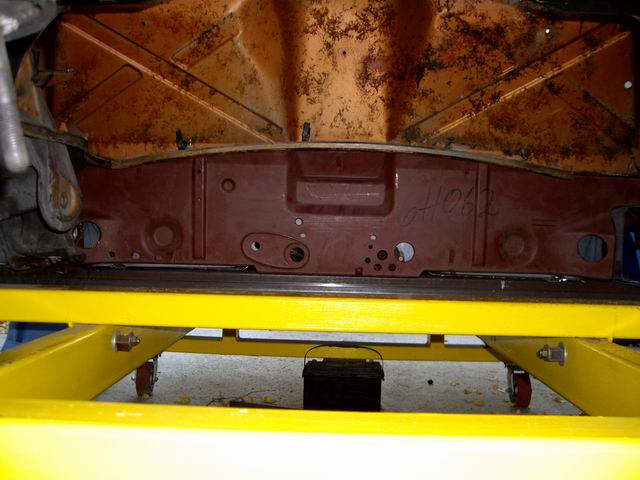

Mocked up the inner and outer firewalls to see how everything fits. No welds just loose.
The outer is a NOS piece and the two lower inners are AA. The AA parts fit pretty damn good. All the locating holes and boss's line right up with the original piece.
(George I am impressed)
Before I weld these in I will repair the tunnel. I also need to modify the outer firewall because my car is a 75 and the NOS part is for an early car. I will resize the shifter bushing reinforcement to match the later bushings.
I will also need to repair the tunnel lines. I had to cut them to get the PO's previous horrors out of the way. McMaster-Carr has the correct size tubing available. I have a few improvements in store from the factory design anyway.

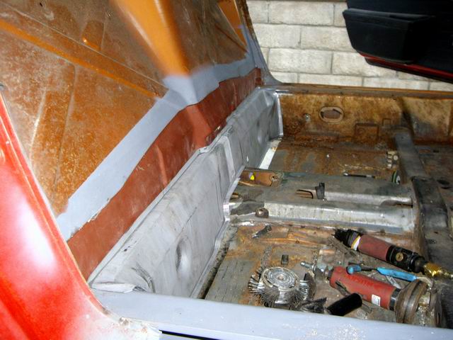

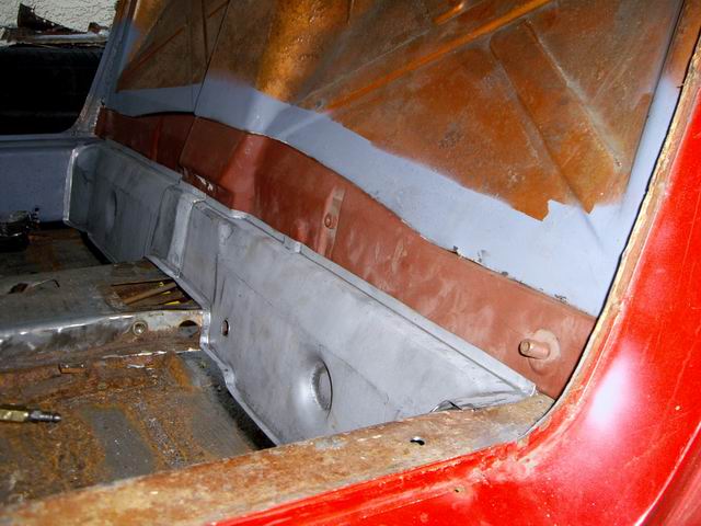

Jeff Hail   Moving along into the rocker and longs. This was h...   Oct 2 2007, 12:08 AM
Jeff Hail   Cut out the rusted outer. Actually only the rear 1...   Oct 2 2007, 12:17 AM
Jeff Hail   Floor metal finished and primed. No filler. I did ...   Oct 2 2007, 12:54 AM

Jeff Hail   Mocked up the inner and outer firewalls to see how...   Nov 3 2007, 08:06 PM
Jeff Hail   Kind of looks like a 914 again! Still lots to...   Nov 3 2007, 08:08 PM
