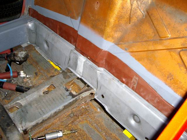

Jeff Hail   Floor metal finished and primed. No filler. I did ...   Oct 2 2007, 12:54 AM

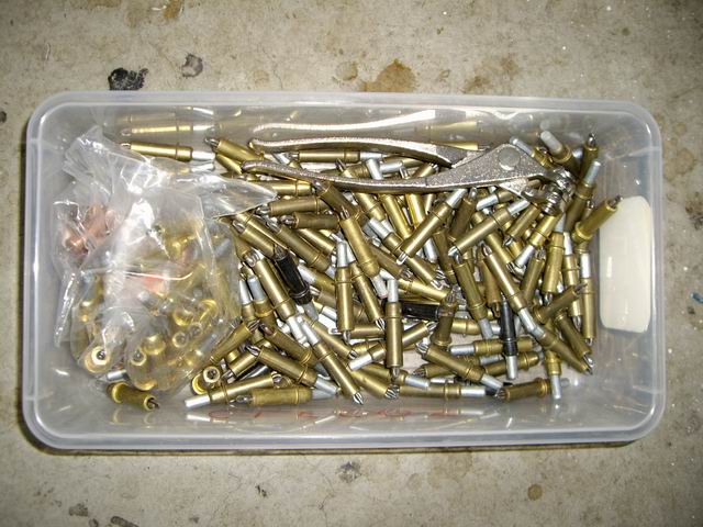

Wes V   For those that may not know; Clecos are clamps th...   Nov 4 2007, 12:11 PM
