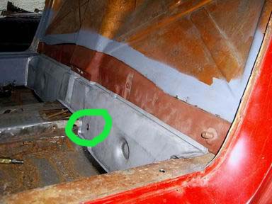

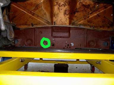

Anyone with an early car know what these holes are for? The holes line up on the inner fire wall and inside the shift rod housing on the outer firewall.
I checked all my disassembly photo's and do not see it on the late body.
Just wondering what they are for?

Jeff Hail   Anyone with an early car know what these holes are...   Nov 3 2007, 09:12 PM
1970 Neun vierzehn   Anyone with an early car know what these holes ar...   Nov 3 2007, 11:58 PM
sixnotfour   Yes, that hole is for a pivot ball , But for 4 cyl...   Nov 4 2007, 10:40 AM
