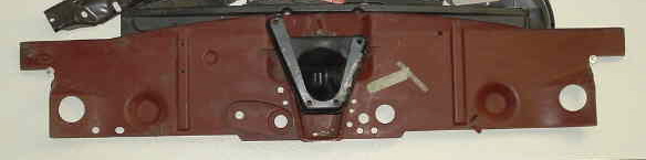

Yes, that hole is for a pivot ball , But for 4 cylinder only. The six uses a simple two bolt type u-joint .
Here is the six wall peice , It has the motor mount welded to it. (note: the black piece is the part that bolts to engine.)

Jeff Hail   Anyone with an early car know what these holes are...   Nov 3 2007, 09:12 PM
1970 Neun vierzehn   Anyone with an early car know what these holes ar...   Nov 3 2007, 11:58 PM
sixnotfour   Yes, that hole is for a pivot ball , But for 4 cyl...   Nov 4 2007, 10:40 AM
