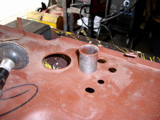

Stuff that is easier to do now than later.

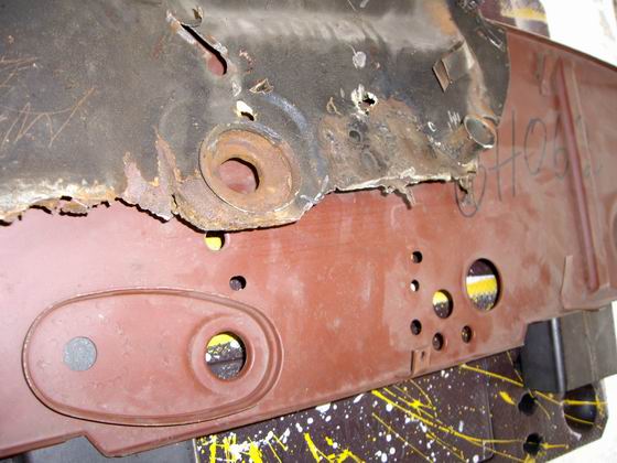

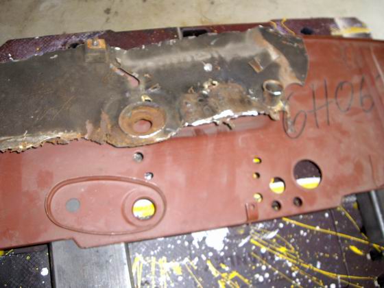

I am using an early firewall (PN# 914-501-119-10) which is for a 914/4 thru 1971 to be put on the 1975 body.
The NOS firewall does not come with a speedo cable spigot tube. The early firewall has some differences. I will update and modify according to my build.
The Speedo Cable Spigot Tube
Lets build one..........
The old section versus the replacement.

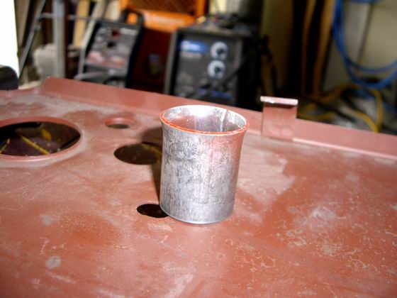

Jeff Hail   Stuff that is easier to do now than later. I am u...   Nov 4 2007, 07:41 PM
Jeff Hail   Wondering how I flaired the tube? After rummaging ...   Nov 4 2007, 07:46 PM
Jeff Hail   Mig welded the spigot to the firewall and some pri...   Nov 4 2007, 07:48 PM
