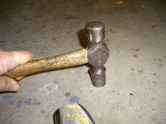

Wondering how I flaired the tube? After rummaging through the tool and junk box's for something shaped like a ball or cone I decided on a ballpeen hammer.
I knew that round end was good for something!
Put the 1-1/4 inch long stub on the ground. Put the round head inside and smacked it a few times with an even bigger hammer until I reached the desired shape.
That myth of hitting a hammer with another hammer is BS by the way.
