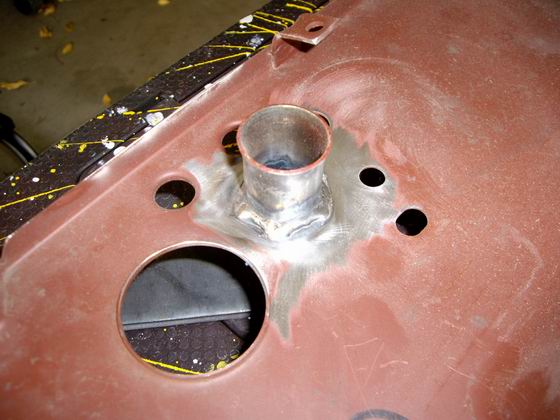

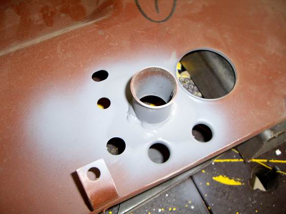

Jeff Hail   Stuff that is easier to do now than later. I am u...   Nov 4 2007, 07:41 PM
Jeff Hail   Wondering how I flaired the tube? After rummaging ...   Nov 4 2007, 07:46 PM
Jeff Hail   Mig welded the spigot to the firewall and some pri...   Nov 4 2007, 07:48 PM
