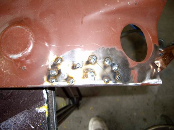

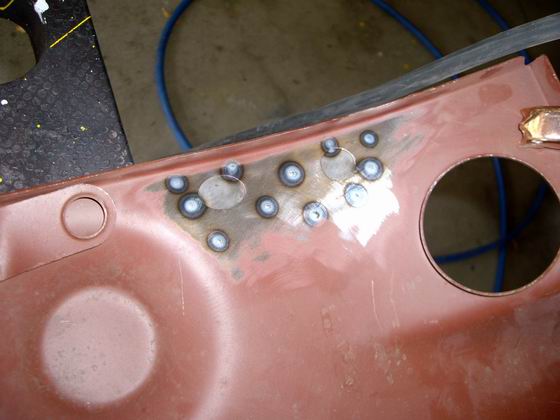

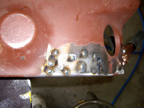

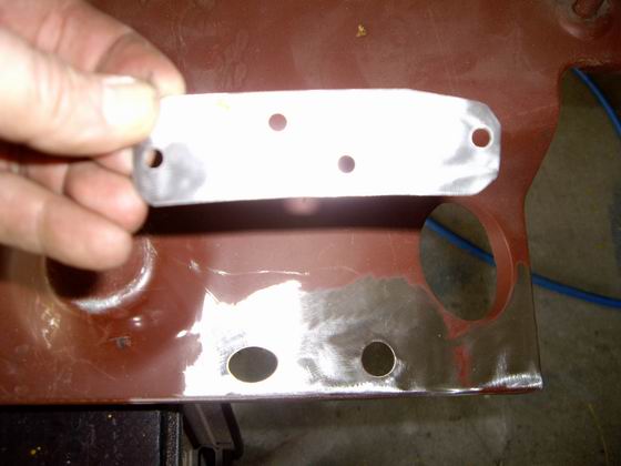

Moving along to the E-Brake Cable delete.
Cut out a rectangle of sheetmetal and punched some holes in it.
Spot weld it to the firewall.
I almost tacked it to the wrong side! Ooops. Caught in time.

Jeff Hail   Moving along to the E-Brake Cable delete. Cut out...   Nov 4 2007, 07:55 PM
Jeff Hail   A little finishing with a grinder and conditioning...   Nov 4 2007, 08:03 PM
