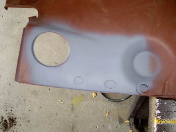

A little finishing with a grinder and conditioning pad. Looks like factory "knockouts" on the engine compartment side. Porsche never had knockouts here except for the 6 cylinder oil tank holes on the driver side wheelhouse. Still looks clean.
If for some reason my E-Brake conversation to the 1995 993 center pull becomes a problem I can always resort back to the original design and add the elbows back in with minimal work. Always plan ahead for curves in the road.

Jeff Hail   A little finishing with a grinder and conditioning...   Nov 4 2007, 08:03 PM
