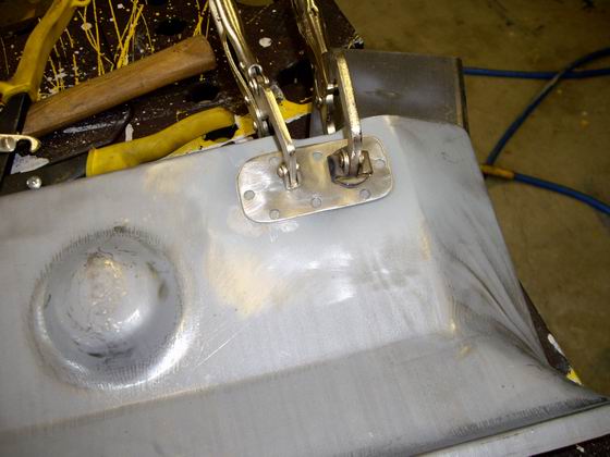

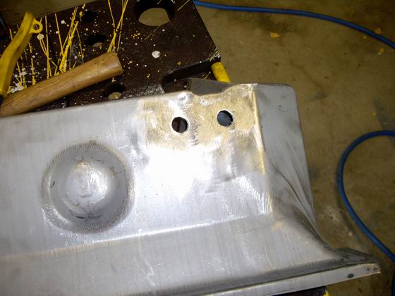

Also the two holes on the inner firewall for the E-Brake cable delete. Gone!
Same procedure. Fab a plate and punch some holes. Spot weld it to the backside.
Wait! those two holes have a raised boss. Better get rid of those also and make it smooth. Hammer and dolly.

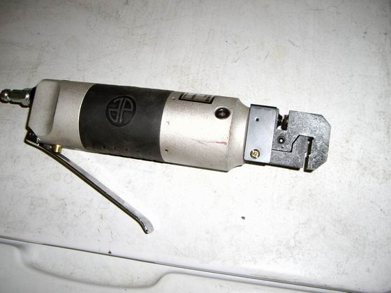

A great tool is the Punch/ Flanger. On one side it has a hole punch which really is an effortless time saver. After drilling out over 500 spot welds at this point in the project I look forward to it. On the other side of the head is a flanger. Great for lapping panels and floors. Makes a nice finished step in sheetmetal and looks professional.
