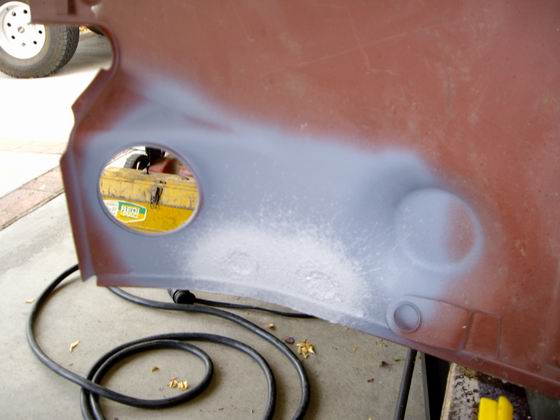

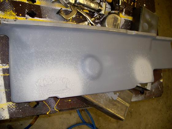

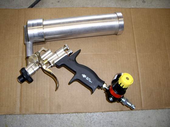

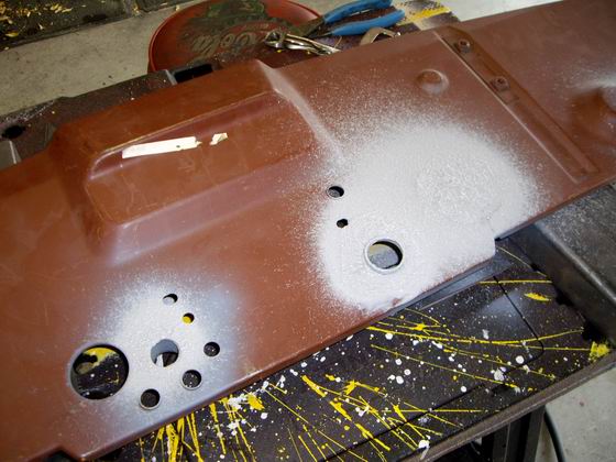

Corrosion Protection:
I cannot stress enough about corrosion protection on a 914. These little buggers rust from the inside out.
All area's that were welded get a coat of primer. I then went over the primer and spotted with Wurth Seam Sealer. This sealer looks like the OEM sealer Porsche used on all the seams and under the rockers where the floor connects.
Today it is the factory recommended sealer for Porsche, Mercedes and BMW.
As Snoop Dog would say "this is the shizzle". It cannot be beat.
Most of the area's coated will never be seen so appearance wasnt a priority. Doesnt matter, it still needs to be sealed. Primer alone doesnt cut it. Even between the firewalls a few minutes spent will last a lifetime.
