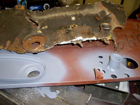

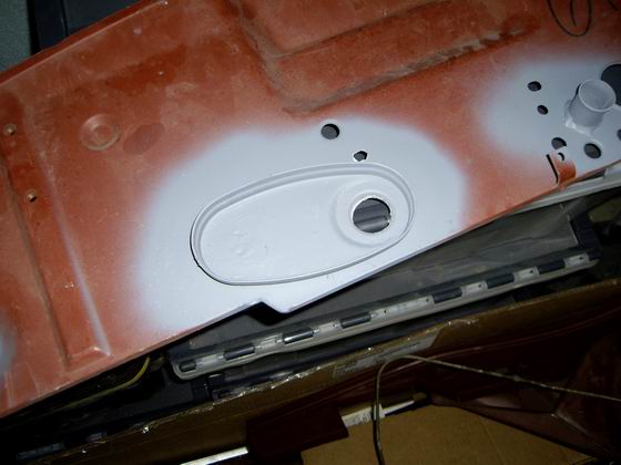

I decided to leave the early boot cup on the shift shaft housing instead of swapping to the late round style. The early firewall has about 40 resistance welds holding it in and would do more damage to the firewall removing it and installing the later one so I left it in.
Notice the hole to the left of the shift shaft has been deleted.
Fitting a bushing to the shift shaft will not be an issue. The early bushing is larger and can easily me made from Delrin or a sealed bearing installed. I have seen the Patrick Motorsports Bulkhead Bearing on another car it it is superior to the OEM application in every way. For $43 the PMS is a no brainer.
