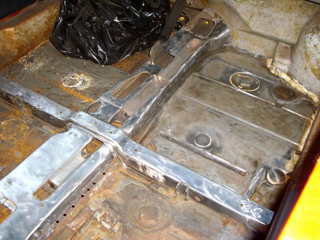

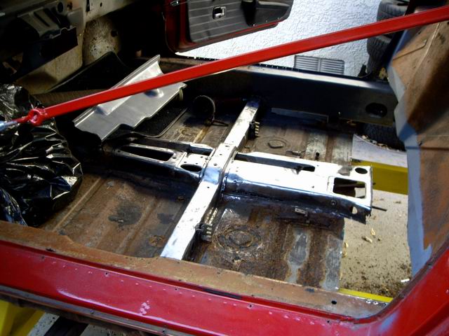

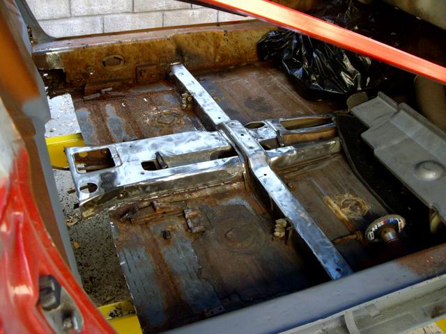

Didnt get any work done on the tub during the week and forgot to order the tubing from McMaster Carr soooooooooo I can't work on the throttle and clutch tubes. I can't finish the inner and outer firewalls until the tunnel work is completed yada yada.......
Ok sheetmetal happens! Move forward to the mid-floors.
I like to focus on an area and set small goal's. More seems to get done that way instead of jumping around.
Lets get to work.
Today I worked on the passenger front 1/4 floor, tunnel and floor crossmembers. Stripped everything to bare metal. I was surprised this area was not bad at all. I little flash and surface rust but easily prepared. I still have to section a piece in the drivers side rear tunnel at the firewall junction due to corrosion but that can be done later. Might as well get some thing done while I am waiting for parts.
The driver and passenger side rear floor will get replaced. I do not want to make the cut until I have the firewall tacked in and positioned.
I stripped the rt/ qtr front floor with a scraper long ago. I then went over it with a 3 inch wire wheel on a die grinder to remove any scale. Then removed all the sealer up to the front bulkhead with the Wurth (Flail). Any remaining glue/adhesive for the floor pads removed with Lacquer Thinner. Then used a conditioning pad on a die grinder to knock everything down smooth.
I want to leave as much original zinc and factory primer as possible since it is still in good condition up to about an inch in front of the floor/ seat crossmember.
