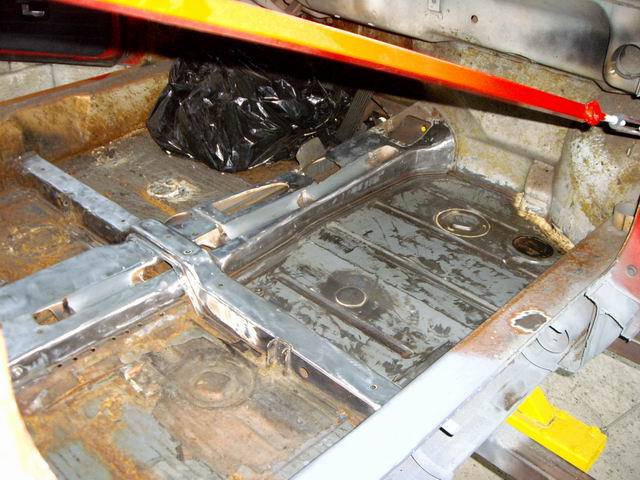

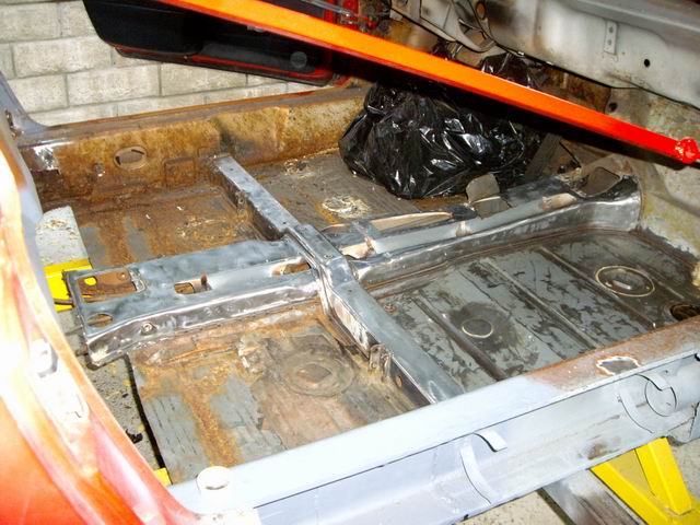

Again the rear floor behind the seat crossmember is getting replaced. It's only function is to link the longs to the tunnel for support while I work in other areas for now.
Back to the front right 1/4 floor area. Stripped and all tunnel connections (flanges) prepped with a solution of phosphoric acid/ zinc phosphate (same thing as Metal Ready), let sit for a half an hour and go hit a couple cups of Java.
Once the etching solution has converted any flash rust that I couldn't remove by machine (Which was very little) I wipe with a dry towel. The solution is still working. Then I go over it with a wet rag and let it air dry. I really don't like introducing water to the interior but it is the only way to make sure any residual is nutralized. I then force out any liquid residue with compressed air that may be hiding. I aid evaporation with a propane plumbers torch just warming any area's that liquid may be hiding in the tunnel/ floor flanges.
