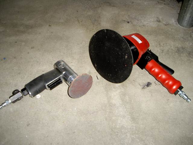

Once everything has sat a little while it is then sanded. First 220 and then 320 to accept epoxy primer for proper adhesion.
If you want primer to stick don't put it directly over a converted surface. You need to sand and abrade the surface first. Not course enough to remove any conversion coating but enough to rough it up.
The Mini DA works great on the floor's. It's small enough to get into the recess's yet still large enough to work quickly. A normal DA sitting next to it's little brethren.

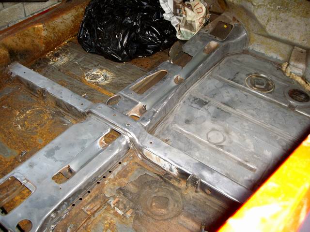

Jeff Hail   Didnt get any work done on the tub during the week...   Nov 10 2007, 09:50 PM
Jeff Hail   Again the rear floor behind the seat crossmember i...   Nov 10 2007, 10:14 PM
Jeff Hail   Once everything has sat a little while it is then ...   Nov 10 2007, 10:24 PM
Jeff Hail   Working in smaller area's makes it easier to m...   Nov 10 2007, 10:48 PM
