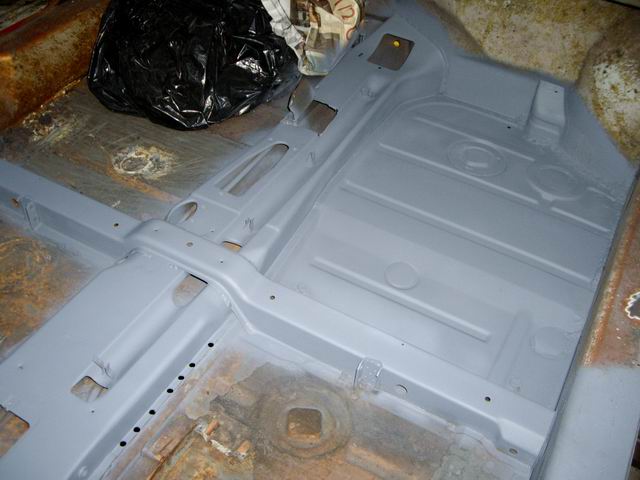

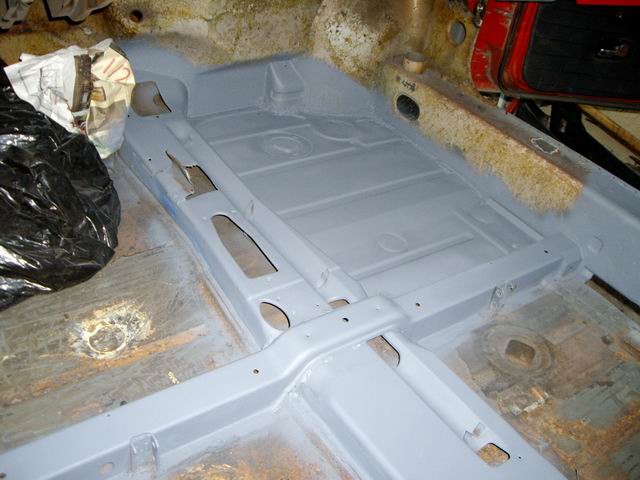

Working in smaller area's makes it easier to manage and focus than large surface area's. Might be some overlap but when a week may go by between work on the project results happen. Unless you are doing this in a production shop set goals and smaller area's to work on.

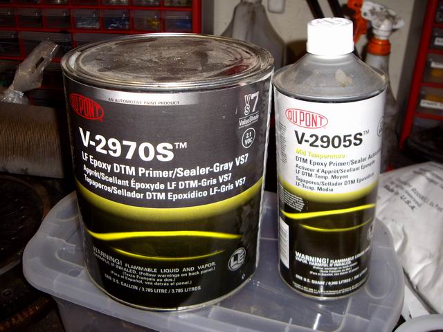

After the application of epoxy primer.

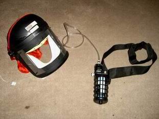

Helpful advise....DO NOT SPRAY THIS TYPE OF PRODUCT UNLESS YOU HAVE A POSITVE PRESSURE RESPIRATOR.
A PPR uses a forced fresh air supply and is the only way to save your lungs, brain and life.
Catalyzed Epoxy Primers and Isocyanates will take your life if you do not follow the proper safety measures for body and respitory protection. No car is worth your health, brain or life!
