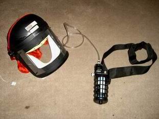

Helpful advise....DO NOT SPRAY THIS TYPE OF PRODUCT UNLESS YOU HAVE A POSITVE PRESSURE RESPIRATOR.
A PPR uses a forced fresh air supply and is the only way to save your lungs, brain and life.
Catalyzed Epoxy Primers and Isocyanates will take your life if you do not follow the proper safety measures for body and respitory protection. No car is worth your health, brain or life!

Jeff,
What brand of respirator is this? If you don't mind me asking what was the cost?
I've looked for those types of respirators and most are over $1,000.

Sata Vision 2000. They retail for $800, I found mine on ebay for $300 new in sealed box.
