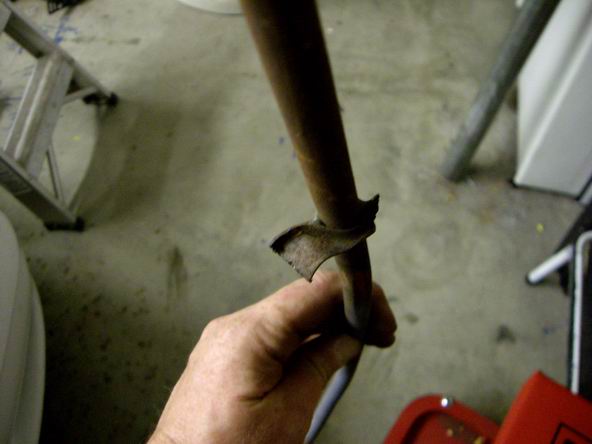

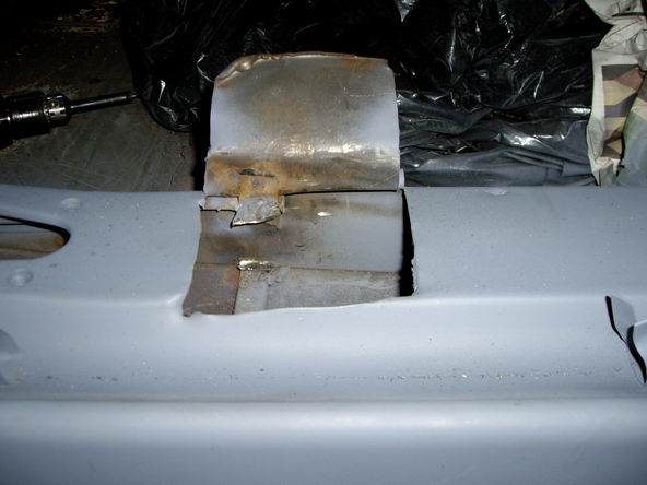

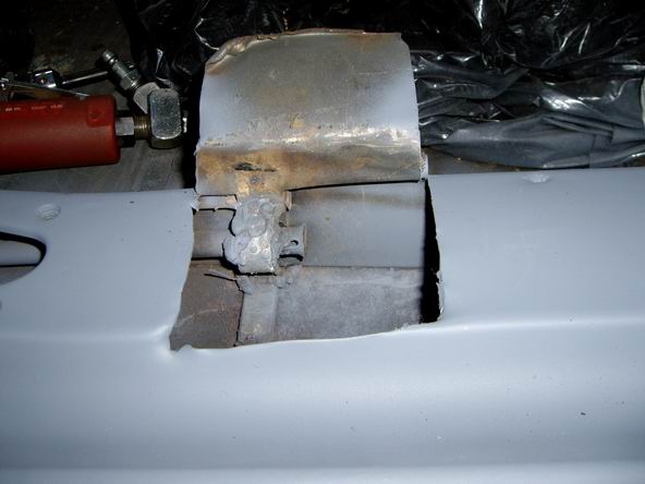

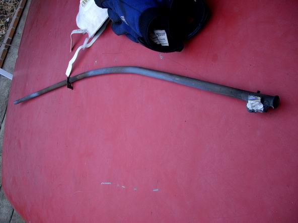

Had second thoughts on the prior owner repairs to the clutch and throttle conduits.
Someone put about 2lb's of crap in the tunnel. Looks like it was repaired twice. First time a gob of coat hanger and fire were done, then later a bracket added with a wire welder. This has got to go!
I can hear Steve Martin now....."stay away from the tubes"!
Clutch conduit removed. Pretty easy actually.
The front was held in pretty well. Looks like the second repair was overkill.
I still do not like it.
The rear clutch tube bracket was intact but the factory bracket which looks like formed 20 gauge steel is going to get a make over. Too wimpy in my opinion.
I am going to leave the throttle cable conduit as is. It is intact and does not have pressure on the tube like the clutch cable does. It is still solid. One less thing to replace.
