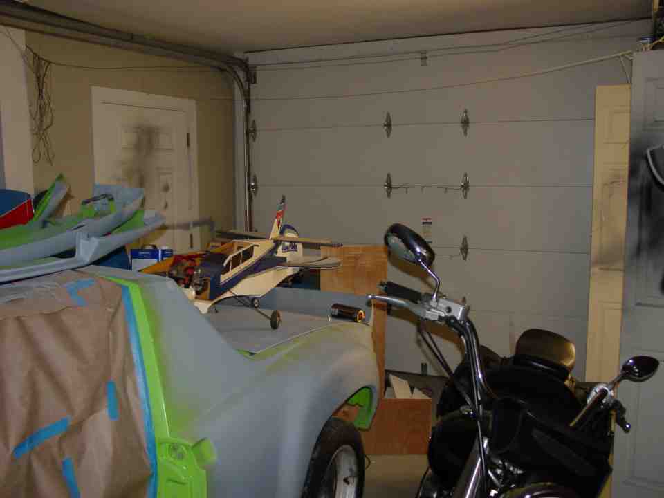

And lastly how she sat for the last 3 months......
