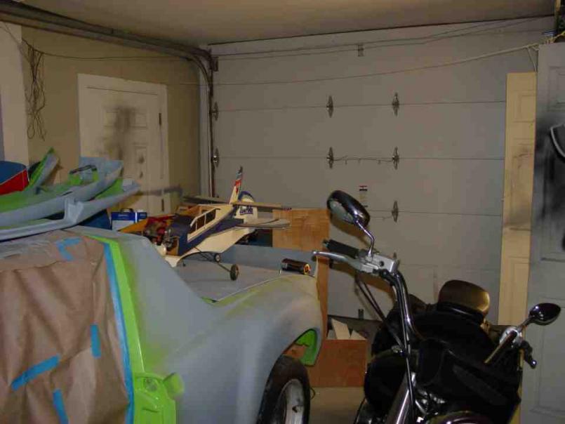

degreeoff   OK so I wanted to wheel her out for a few body pei...   Feb 14 2008, 03:46 PM
