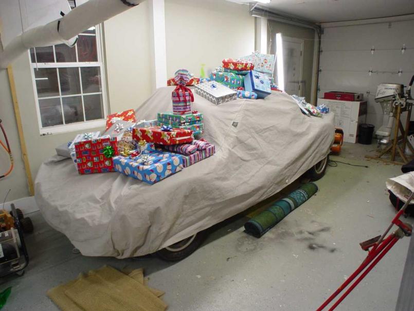

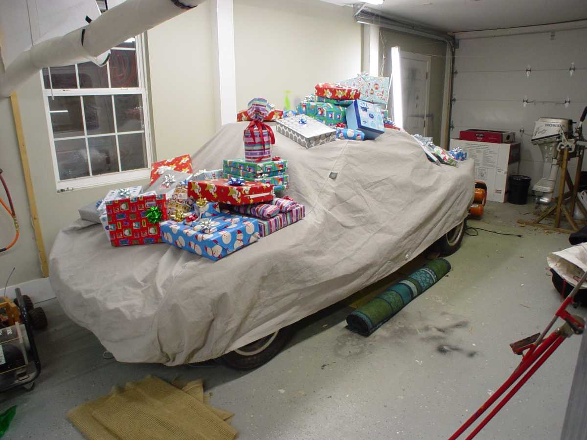

Now if only she were done when I wake up Xmas morn....I will settle for the look on my daughter/neice/nephews and girlfreinds faces when they open their gifts!

degreeoff   Now if only she were done when I wake up Xmas morn...   Dec 23 2007, 10:40 PM
