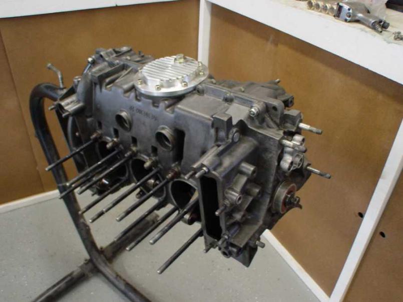

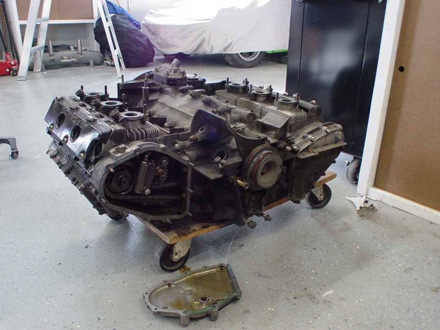

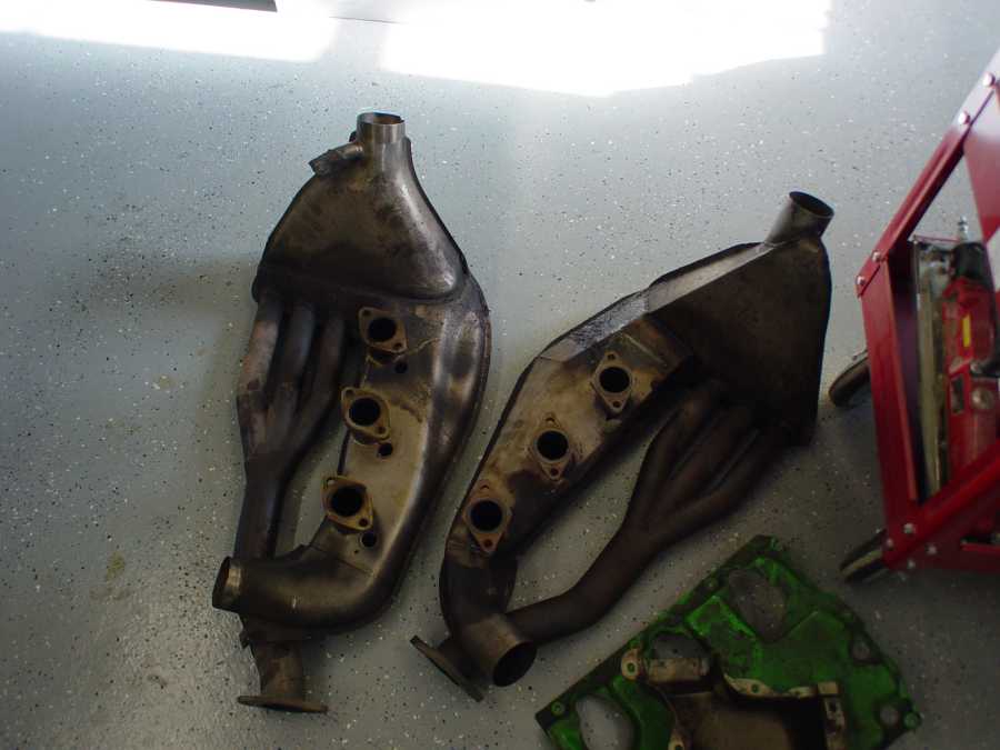

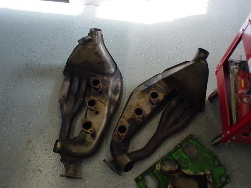

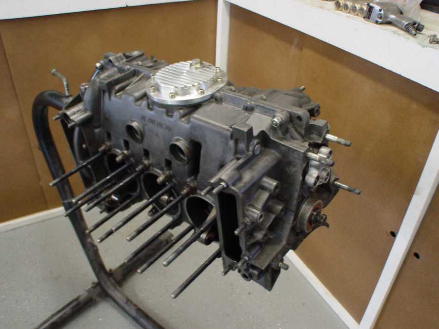

Well I am on it now....Progress includes teardown of my 2.4 ltr doner which was a STEAL!! I found this motor on the bird board and bought it because it was a 2.4 with a 7r case for my # 2 engine . Guy had it sitting in the kitchen of his high $$$ NW DC apt on the 9th floor. it came complete!! with hyd tensioners, SSI's, complete CIS, dizzy with Ign module upgrade, and turbo valve covers and something I just discovered...a neat billit sump plate cover.....I paid $950....I sold the CIS for $275 and the rest will pay for plus profit me I am sure as well as give me a 'T' motor 7R case that will end up with my 2.2 'S' pistons and 'S' cams with 'S' spec ported heads!!!!1 Ha ha ha ha ha...2 engines @ 200+ HP....More power Ru hu hu hugh. (yes I will be looking for a ass dragger after I finish this car)
The short block you see is a 50k mile motor already line bored with case savers and will be a 2.7 with 9.5 to 1 Ross P & C's, GE 40 cams, ported heads, webers and a crank fire ignition. (IMG:style_emoticons/default/beerchug.gif) You see my bench where I have yellow storage bins full of all my rebuild hardware from PP with typed labels...anal I know!!

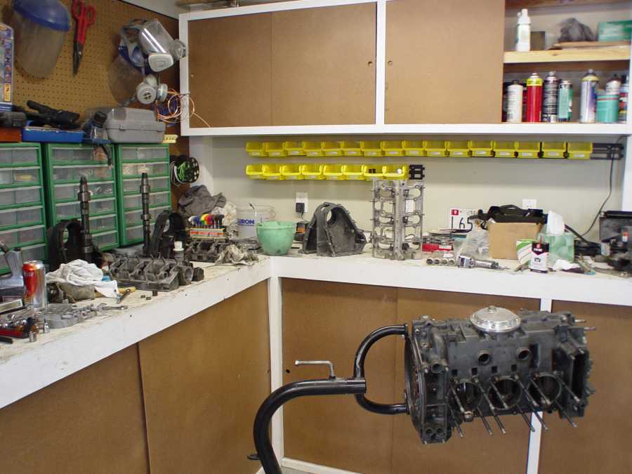

degreeoff   Well I am on it now....Progress includes teardown ...   Jan 6 2008, 11:36 AM
