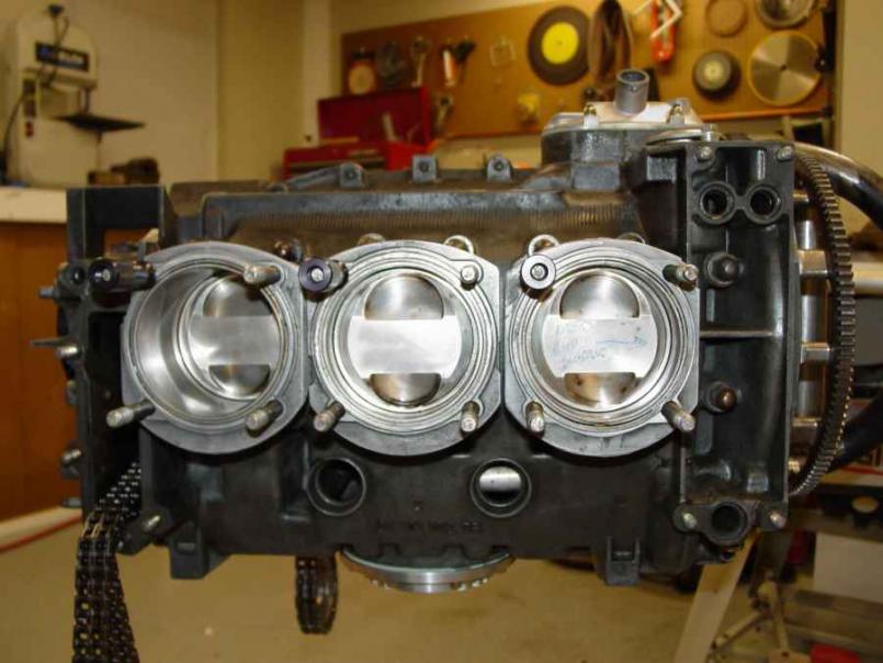

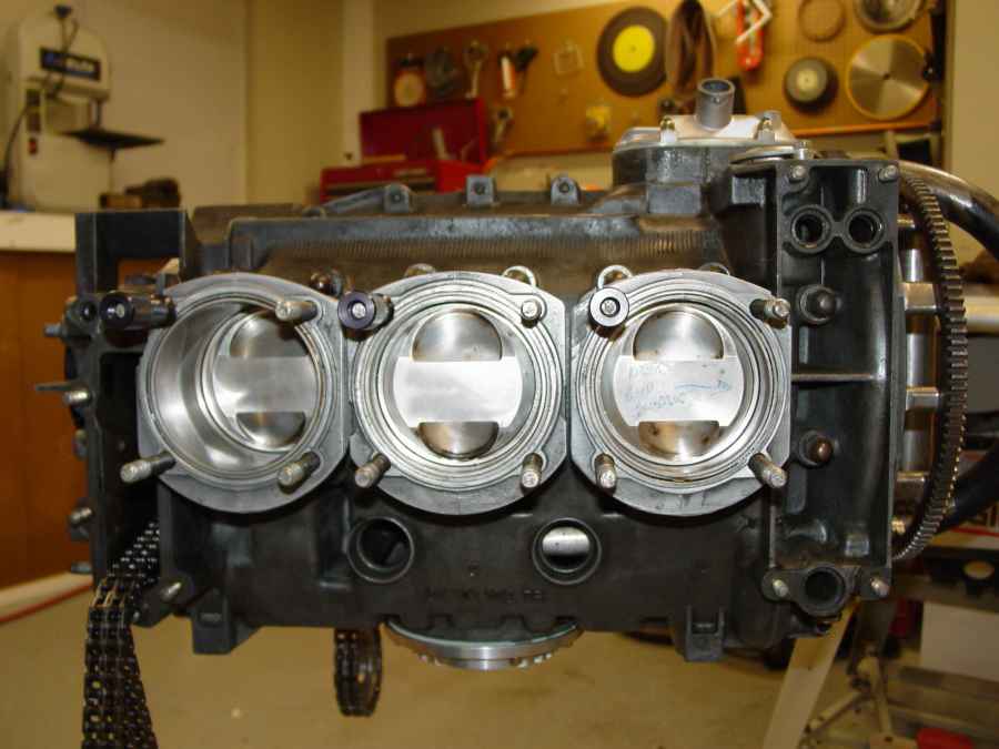

Well I got the P&C's on...deck height @ .987mm....ouuu its tight but it'll live with the Ross pistons and GE40 cams...while installing I A) forgot while on piston/cylinder #5 that the wrist pins needed 2 spiralloc retainers...(I had a bag of of them and thought there were 6...LOL) @ 5 I realized that there were 12 MINUS 1! that I now wait for from Cali.... AND (IMG:style_emoticons/default/cool.gif) that one of my cylinders had a wee bit of pitting on the sealing surface that I needed to swap out...THANK THE LORD I had a spare set from one of my spare motors....of the same height group
I will keep ya'll up to date as I progress as this is my first 911 build and I am SURE I will F up a few more times.....Cam timing is going to be a bitch.... (IMG:style_emoticons/default/smash.gif)

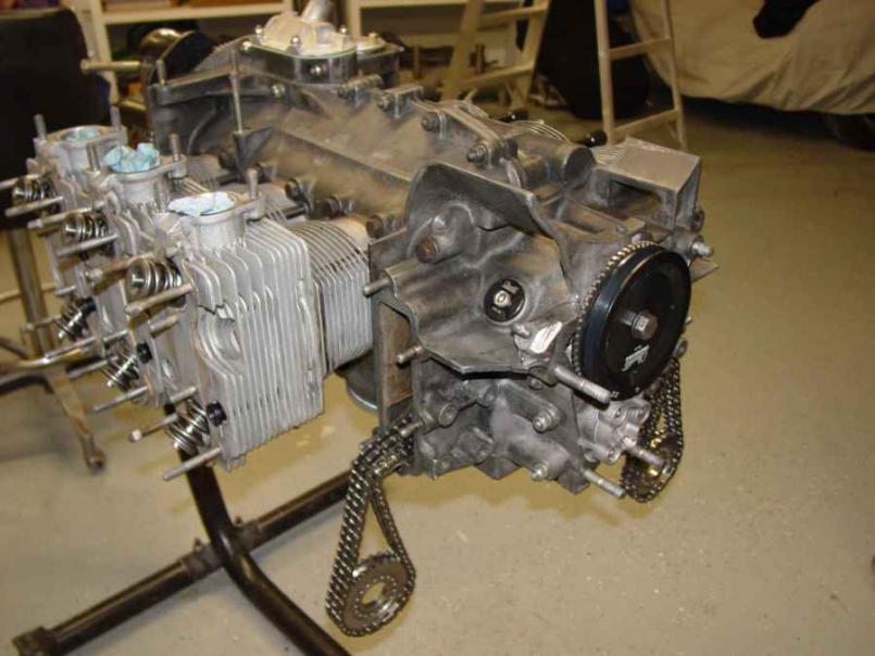

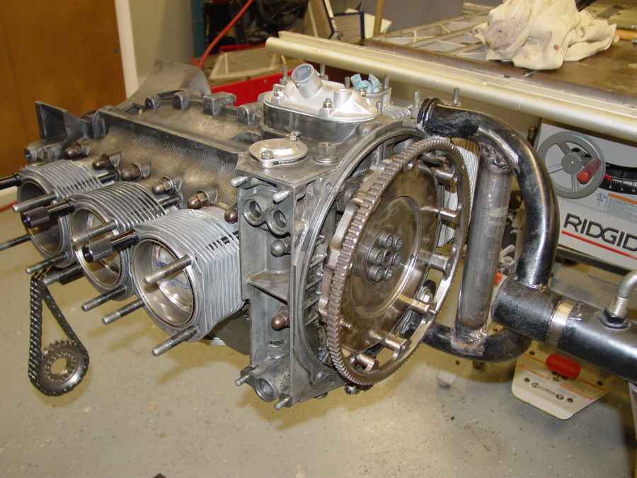

degreeoff   Well I am on it now....Progress includes teardown ...   Jan 6 2008, 11:36 AM

degreeoff   Well I got the P&C's on...deck height @ ....   Jan 10 2008, 05:41 PM

jaminM3   I thought less than 1.3mm of deck height is pushin...   Jan 14 2008, 10:08 AM

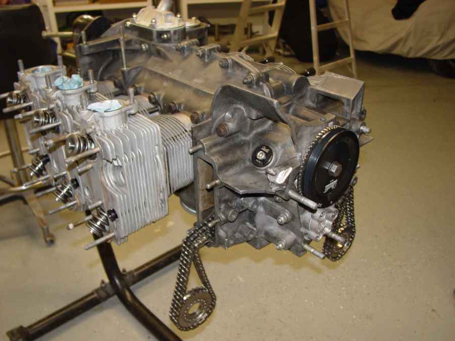

degreeoff   Ok so I started out with waynes book How to rebuil...   Jan 27 2008, 08:27 AM
