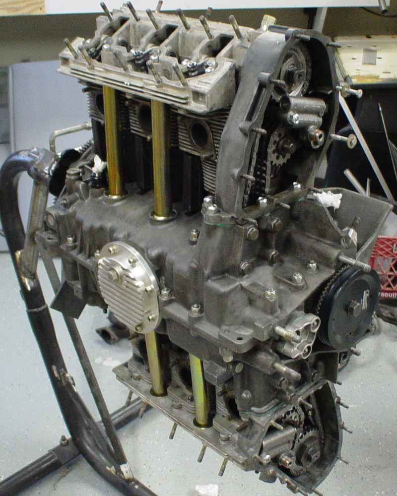

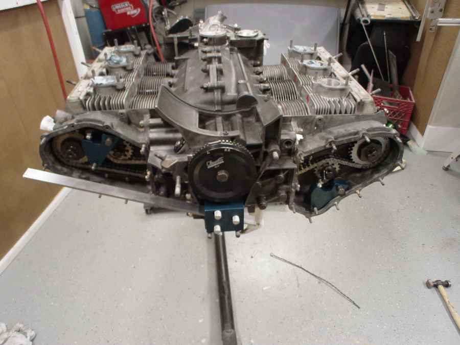

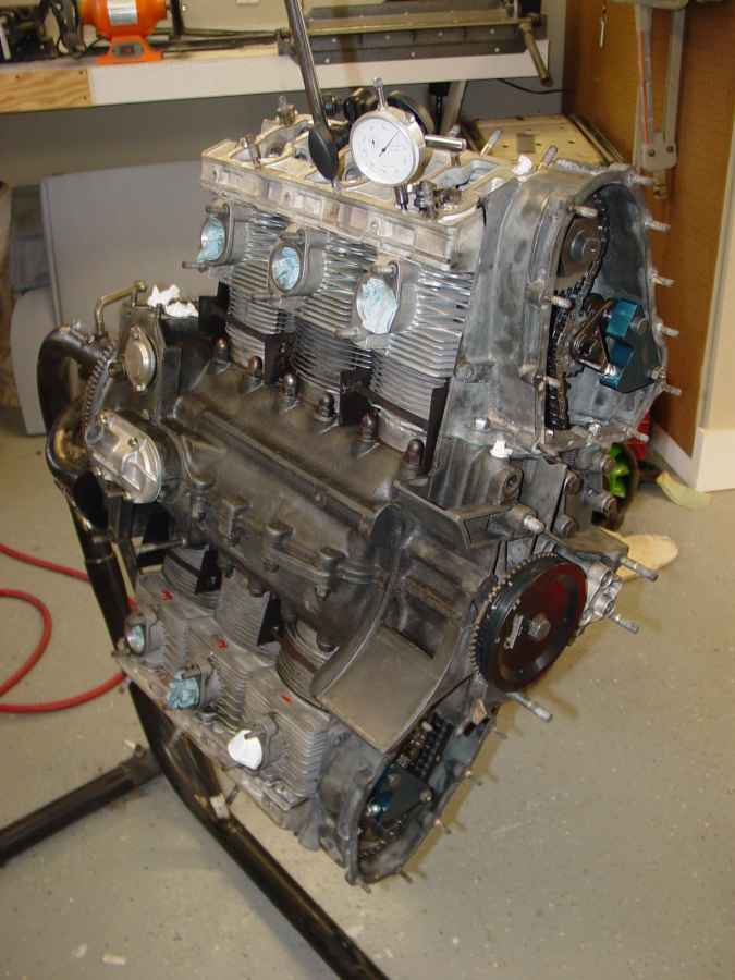

Ok so I started out with waynes book How to rebuild and modify porsche 911 engines......OKay it was a big help BUT (IMG:style_emoticons/default/WTF.gif) with some of the writing....It took me 6- re-reads to understand some of it ( all cam timing issues before it clicked into place....THEN it really clicked. I could do one of these in my sleep.
So the spiralocs came in from Cali, folks over there @ Ross pistons kick ass! They just sent me some @ no charge even though I didnt originally buy the pistons cool shit.
Pics are of the mock up / preassemble showing cam timing and the sprocket depth measurements. I got the tools off Ebay and they were a hell of alot cheaper than the pelican tools (IMG:style_emoticons/default/biggrin.gif) and the last one is of my purdy baby all set and ready to be sealed up. I have all my valve covers/cam tower covers/fan/fan housing/ intake manifolds/throttle linkage/K&N airfilter tops-bottoms getting powder coated now...it'll be a red and black motife' (sp?)
