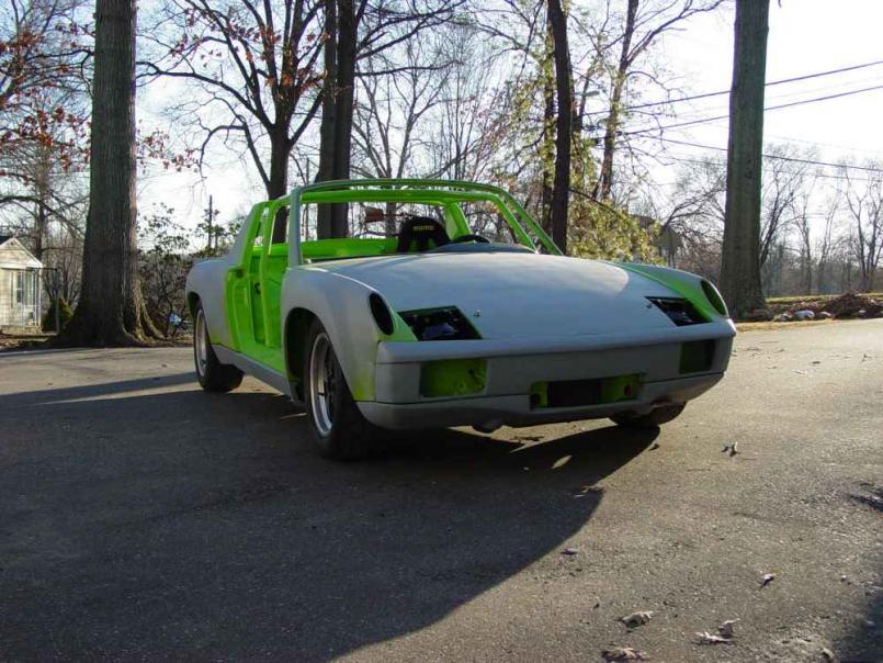

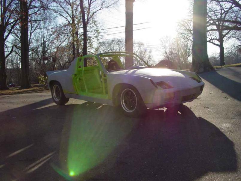

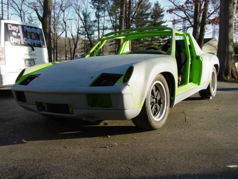

OK so I wanted to wheel her out for a few body peices on pics....NOTICED some SERIOUS waves in the hood (fr) ...damn it all shows in natural light!!! (back to bondo!!)
