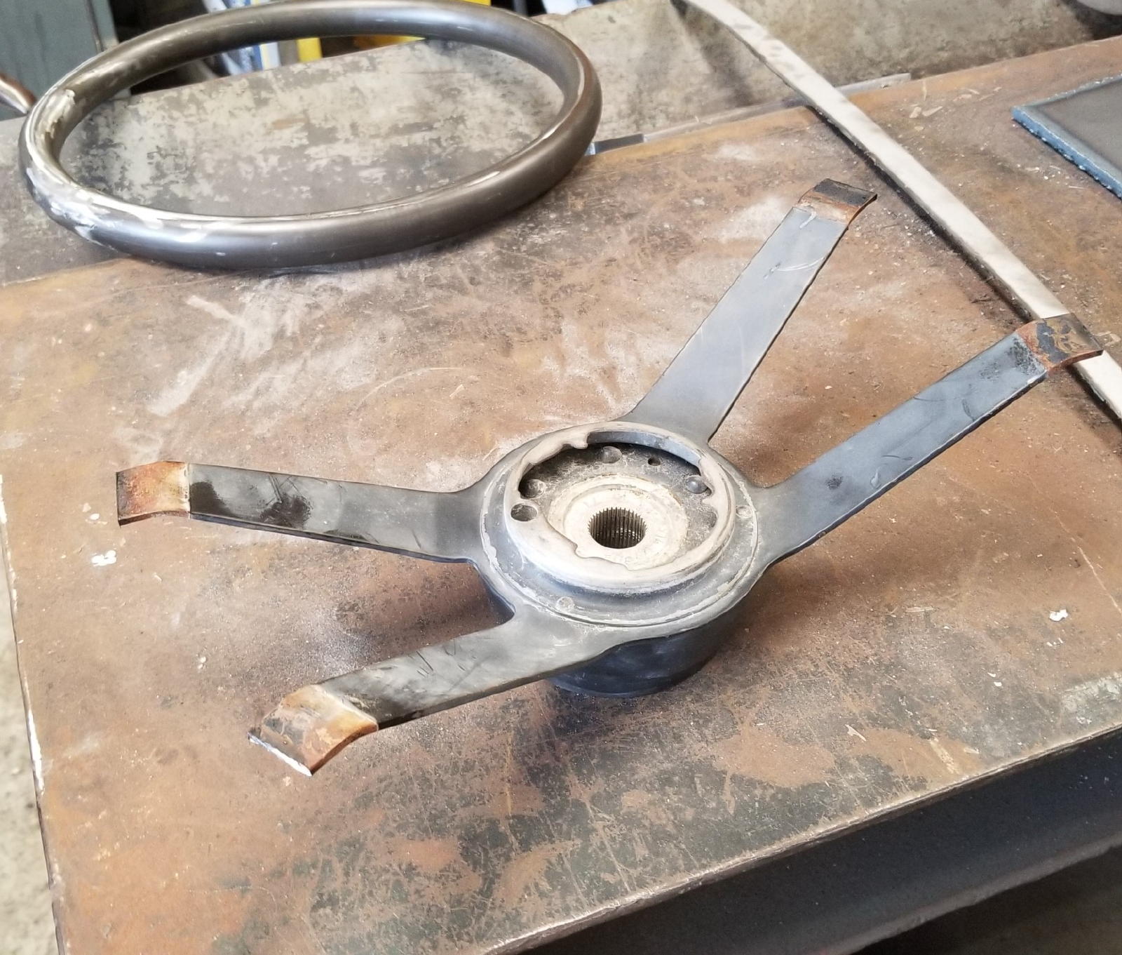

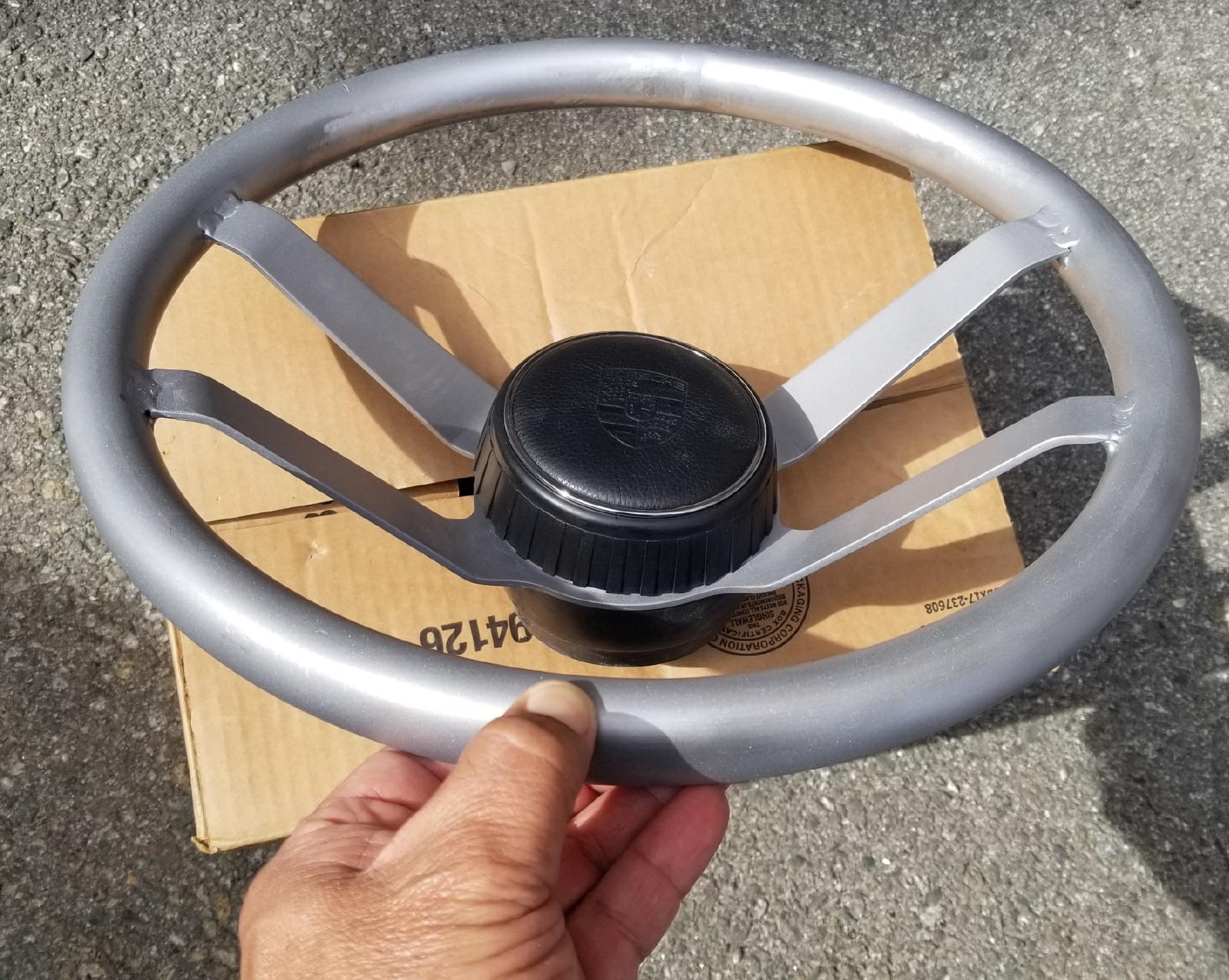

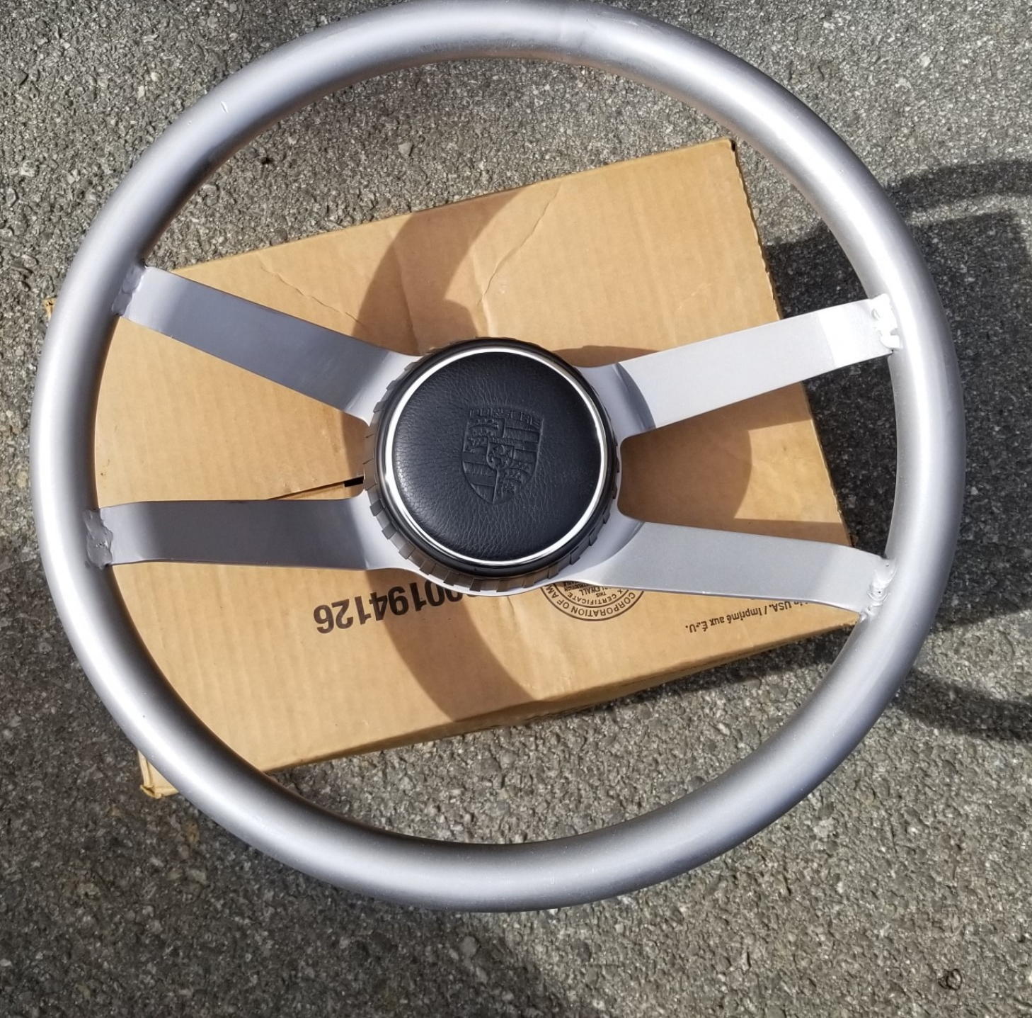

> Modified 914 or 911 RS Type steering wheel (my version), 30mm grip, 340mm Dia , 40mm deeper than stock
ValcoOscar
post Mar 19 2019, 04:13 PM
Garage Life
Posts: 2,690
Joined: 19-November 13
From: SoCal
Member No.: 16,669
In the works....
I like these steering wheels with RS / GT type centers but even the 360mm Dia wheels are a tad big IMO
Honey...I'm shrinking my steering wheel. (IMG:style_emoticons/default/happy11.gif)
To be continued.....
Oscar

ValcoOscar   More photos showing size differences. Opted not t...   Mar 19 2019, 09:39 PM
Retroracer   Looks great Oscar! How did you roll the outer?...   Mar 19 2019, 09:55 PM

ValcoOscar   It took me several attempts and unfortunately I sc...   Mar 20 2019, 08:27 AM
Mark Henry   It took me several attempts and unfortunately I s...   Mar 20 2019, 08:46 AM
gereed75   My plan was to cut the rim portion out of flat sto...   Mar 20 2019, 08:43 AM
ValcoOscar   My plan was to cut the rim portion out of flat st...   Mar 20 2019, 08:49 AM
