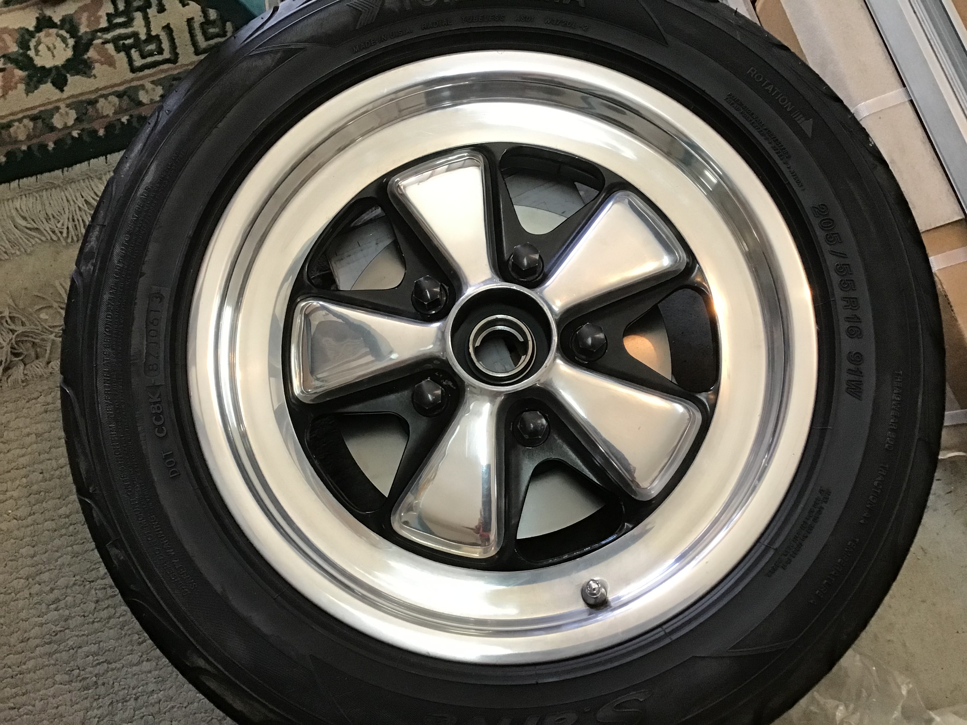

I am more than a couple of years into my restoration of my ‘73 1.7 (now 2.0) but did not want to bore everyone with the same old stuff you have seen before. However, I am very thankful that many members here, take the time to post there work in detail. I have followed Brent’s (bbrock) post and have used many of his examples. In fact, I have adopted his idea of painting the trunks, cabin, underside first and now am doing the exterior panels. However, I do not have the cojones to paint mine myself.
I am getting close to having the car ready for paint. Once I finish this I will get the car back to a roller so I can flatbed to the paint shop. I want to use my old 4 lug Fuchs to sent to the paint shop and not my nice 5 lug Fuchs.
This is where I need advice, I sent my 4 lug hubs to PMB to be converted to 5 lug and also purchased the kit. Since I no longer have the 4 lug hubs, what would be the easiest way to accomplish this. I know Ivan purchase a pair of 4 lug hubs, just wanted to make sure I am not missing something easier.
Also, I want to know if I can install the stub axles without the axles just to get it to the paint shop. There will be no engine in the car.Attached Image
I want to use these wheels to take to the paint shopAttached Image
And not these
