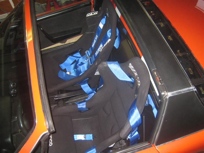

Well if you are willing to change the interior with some permanent modifications I really like my Sparco Evo2. Yhe Sparco Speed for my passenger seat is nice too.
