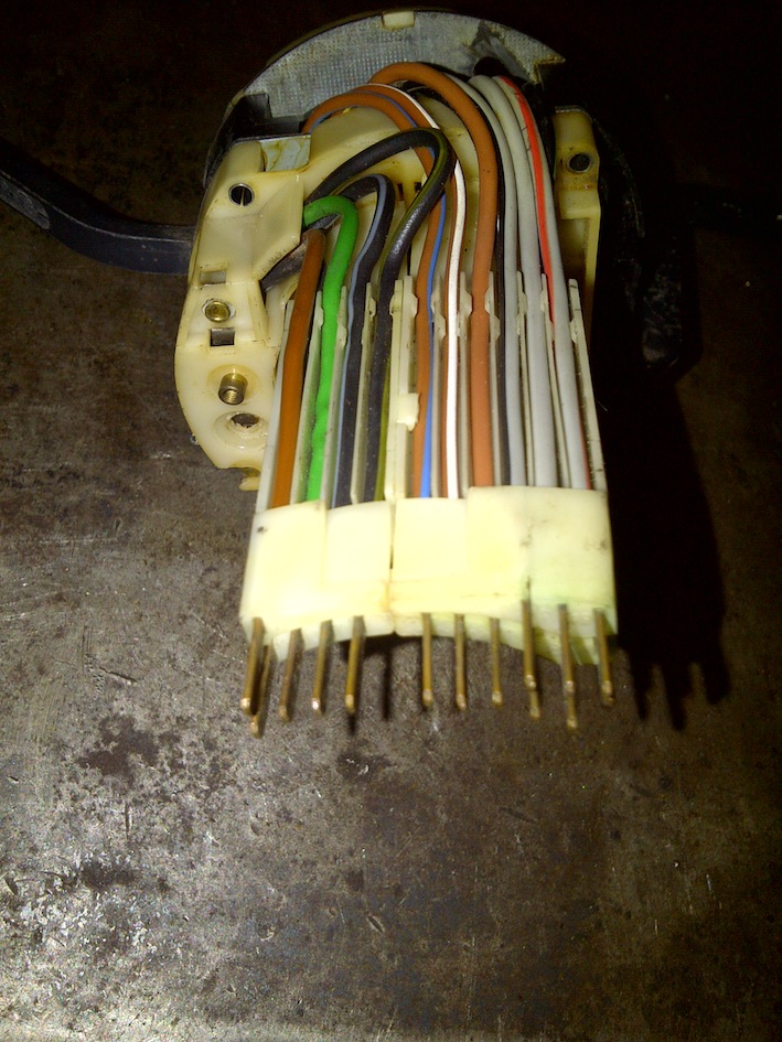

I am trying to figure out what I have here. I noticed that there are two different wiper switches available. 70-72 and 73-76.
This is the one that is in the best condition.
Notice that it only has four pins on the left side.

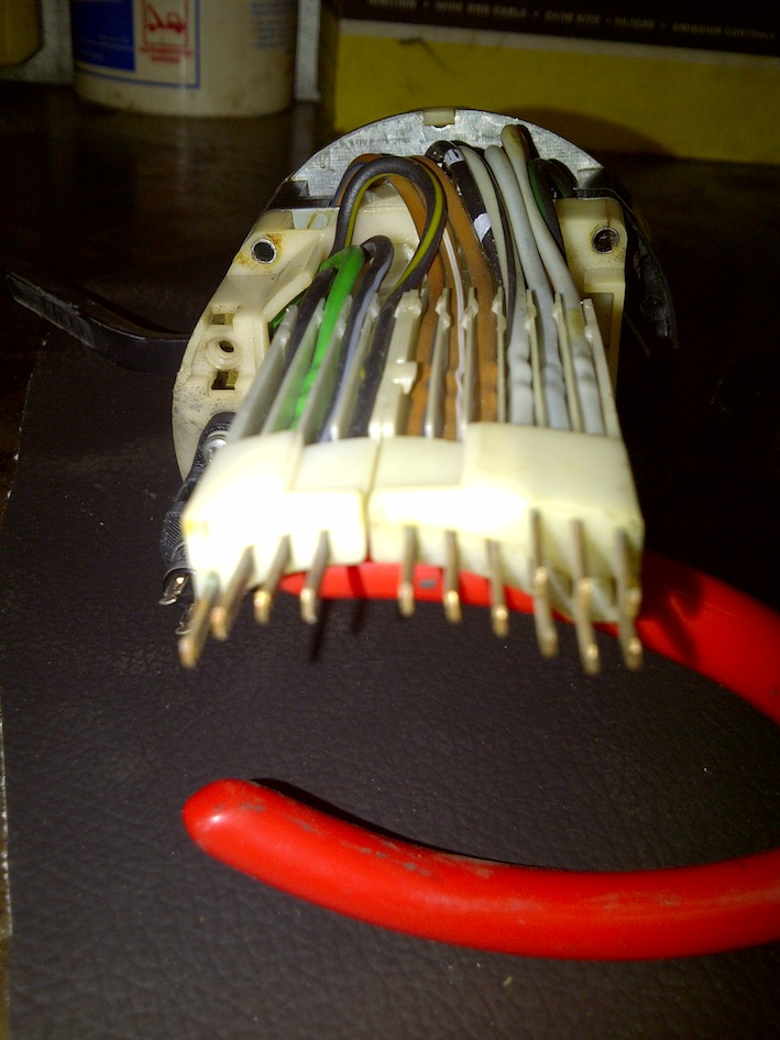

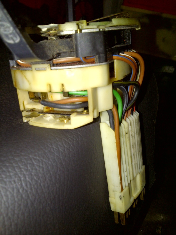

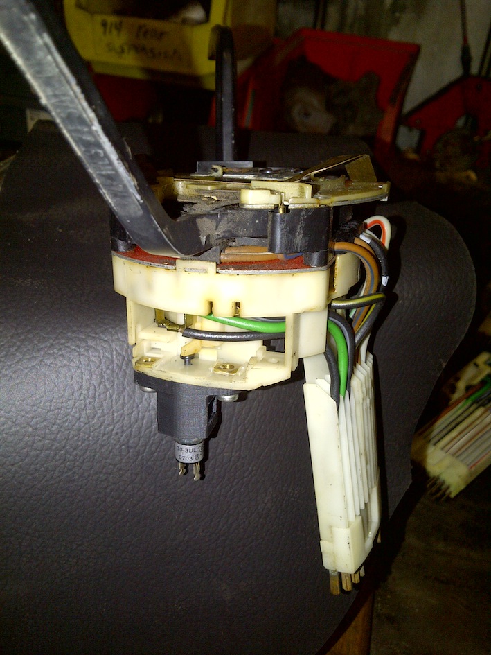

This is the second one that I have. Being in worse condition out of the two.
It has five pins on the left side. The extra one being a brown, which is ground correct?
The switch is also different in that the plunger that would activate the washer fluid has an electrical contact
I am running a wiring harness from a 72 car. Which switch do I need to use? Am i missing pieces from the first switch maybe?

I've done a lot of research on this topic. Here is what I know:
Switches:
1. The 4 wire switch does only support low and high speed. The water is activated through a valve. Wipers will not work when the water valve is activated. The connector has 5 terminals but one is not populated.
2. The 5 wire switch adds the timed delay relay option and wipers on when water valve is open. Note that you can't run an electric water pump with this switch. It just triggers the delay relay to operate the wipers when the valve opens.
3. There is a 6 wire switch used in Super Beetle that has an additional wire for the electric pump. This wire doesn't go to the connector and has it's own spade connector that should be routed to the pump (see picture - note that this switch has both the valve and the pump wire so you can use electric or pneumatic washer system)
4. There is an old 924 switch that has the same functionality as (3) but has a larger connector with 7 terminals. It's an extension of the 914 connector with 2 additional terminals, one of them empty. The pump wire is in the extension. (see diagram below)
5. The signal switch has a tab that prevents the wiper switch to go into the intermittent position. That tab must be removed when an extended switch is used.
