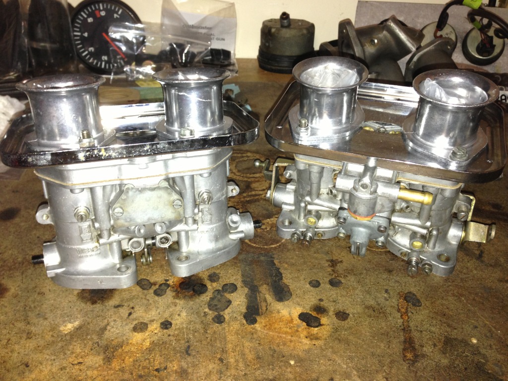

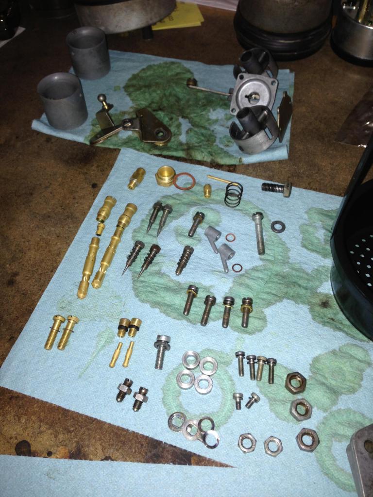

Finals are finished!! So I will have a week to crank out work on the Porsche! I started Thursday night taking apart the carbs and cleaning them in carb dip, checking all the individual parts for damage. Of all the parts only one idle jet needs replacing, the hole is slightly twisted. I am trying to do a bunch of research on what sizing to go with, Doug and Ethan are helping me out a lot with that too! Currently have 30 venturies, 115 main jet, 50 idle, and an f11 emulsion tube (dual 40 webers) don't remember what the air vents are at... Any suggestions will be accepted!!
Right now and until Tuesday I am in San Diego! Wooooow I get to go surfing and hang out and eat good food!
Clean parts from one
(IMG:http://www.914world.com/bbs2/uploads_offsite/i1293.photobucket.com-14538-1364081825.1.jpg)
Idle jet that needs replacing
(IMG:http://www.914world.com/bbs2/uploads_offsite/i1293.photobucket.com-14538-1364081825.2.jpg)

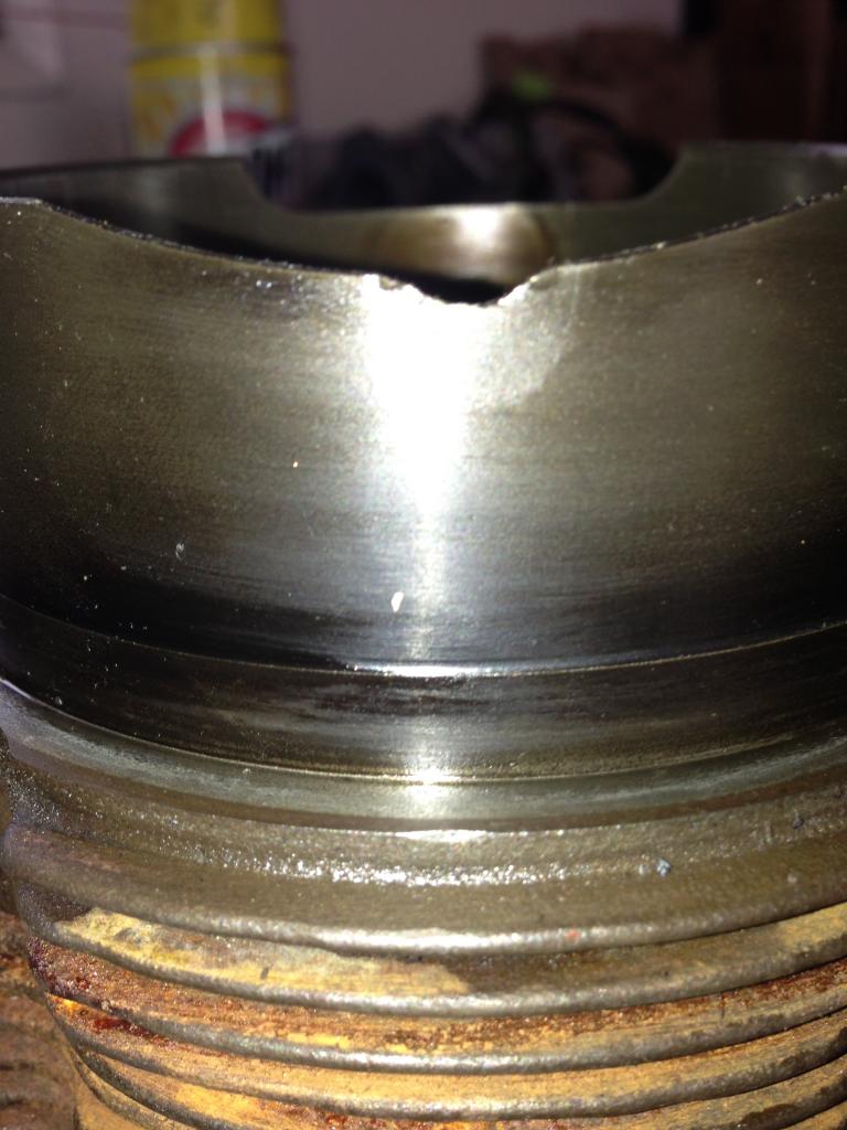

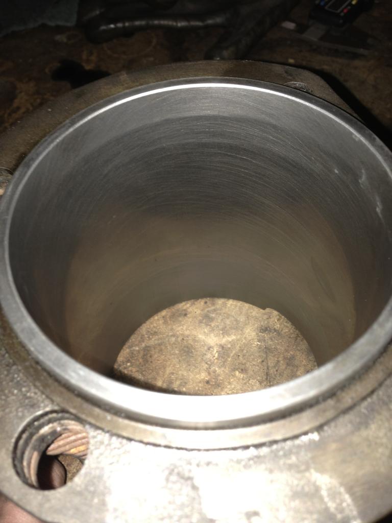

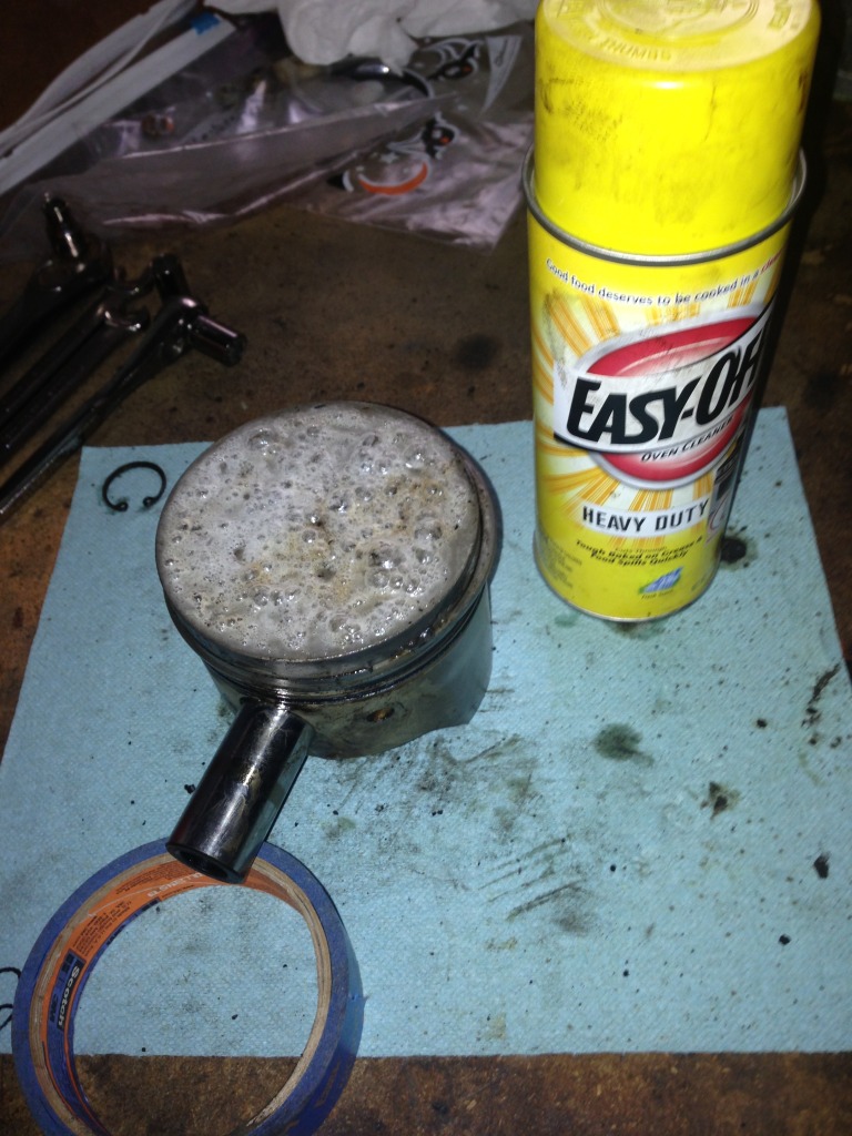

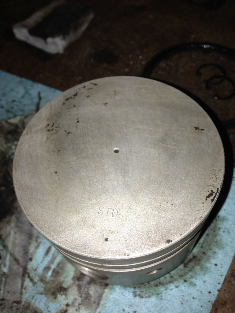

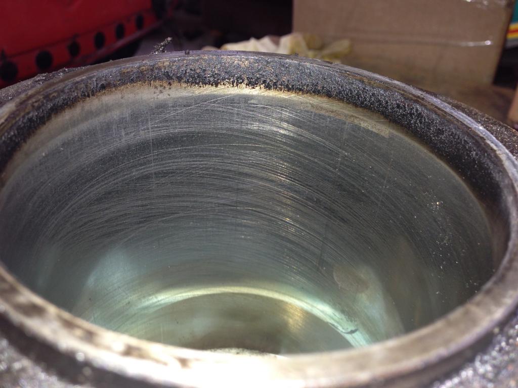

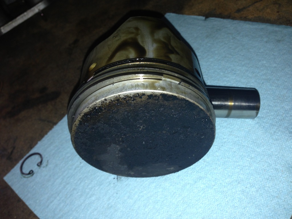

Hey guys, It's been a long time since I last gave an update, and I have been getting work done on the car, but its been slow and little by little, so nothing every seemed worthy of giving an update for...
But heres where I am at with the engine: I have removed all of the pistons and cylinders for cleaning/inspection. Once the piston heads were cleaned of the layers of carbon build up they turned out looking pretty nice. The cylinders all look pretty clean in my opinion, all still have honing lines very visible. Only thing i noticed was that one cylinder at the base (side that goes into case, has a piece chipped off the edge. I feel that it shouldn't be much of a hindrance, but if someone thinks otherwise please interrupt. I have a set of new piston rings to go along with the rebuild, and when i do put it back together do i just need to oil the wrist pins and oil the cylinder walls? or is there anything else that needs lubed up?
The chip
(IMG:http://www.914world.com/bbs2/uploads_offsite/i1293.photobucket.com-14538-1365999111.1.jpg)
cylinder walls
(IMG:http://www.914world.com/bbs2/uploads_offsite/i1293.photobucket.com-14538-1365999111.2.jpg)

Pistons being cleaned
(IMG:http://www.914world.com/bbs2/uploads_offsite/i1293.photobucket.com-14538-1365999112.4.jpg)
Cleaned Pistons
(IMG:http://www.914world.com/bbs2/uploads_offsite/i1293.photobucket.com-14538-1365999112.5.jpg)

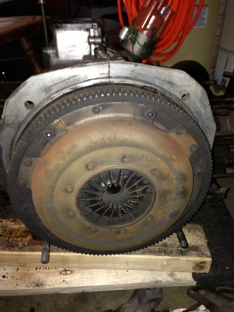

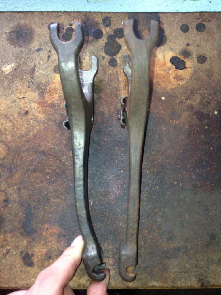

Is there a way to tell if your flywheel is worn by just inspecting it while its still mounted? I ask because I discovered that my throwout fork on the tranny that came with the engine was heated and bent to a curve. I posted a question regarding this and some one had suggested that the flywheel was probably machined. I also anticipate that the clutch cable was significantly stretched, I say this because when i was disconnecting the cable, at the end there were two sockets used as spacers, one regular and one deep socket(!), before the final nut was threaded on the tip! thats a lot of stretch!
This cable was on the old car and will therefore not be used on the new one but i am still wondering if i should be looking deeper into this and be inspecting the flywheel and other close by components for wear? What are your opinions on the matter??
Here are the two forks i have, as you can see one was altered!
(IMG:http://www.914world.com/bbs2/uploads_offsite/i1293.photobucket.com-14538-1366084442.1.jpg)
I have no idea if this picture will help at all, but if you see anything odd, or have a direction for me to start looking in for possible wear spots, it will be very helpful
(IMG:http://i1293.photobucket.com/albums/b583/dfelz914/photo_zps8cc06b64.jpg)
Thanks!
Black22
post Apr 15 2013, 10:31 PM
Post #193
Posts: 886
Joined: 1-November 07
From: Creswell, OR
Member No.: 8,290
Well for starters we can't see the flywheel. The picture you posted is of the pressure plate that is attached to the flywheel. The clutch disc will be between the above mentioned parts.
You can get an idea of wear from looking at the flywheel surface, but if you're not sure, let a pro inspect it.
Also, if those "fingers" around the center of the pressure plate have a groove worn in them, as they appear to have in the picture, I would replace it.

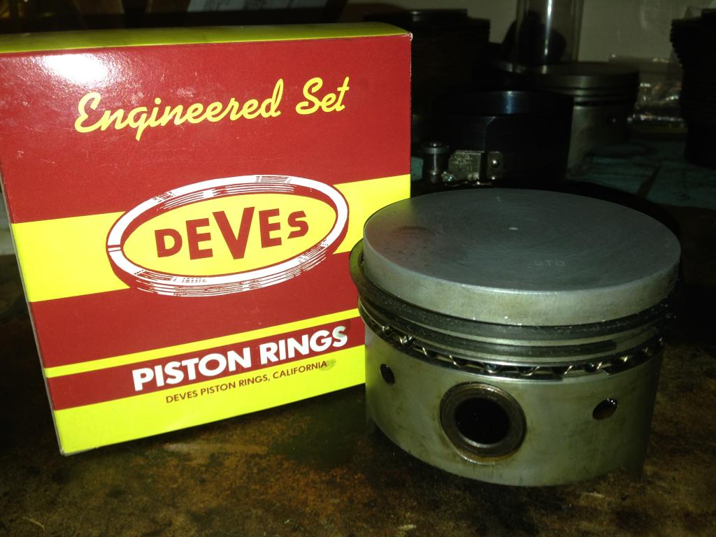

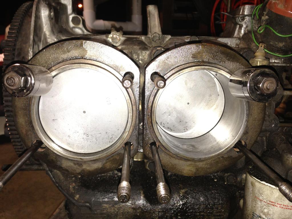

FINALLY STARTED ENGINE REASSEMBLY! (IMG:style_emoticons/default/piratenanner.gif) (IMG:style_emoticons/default/piratenanner.gif) Ethan came over and gave me a big hand in getting me on my way with the engine, YAAAAAY. (IMG:style_emoticons/default/drunk.gif)
New piston rings all around
(IMG:http://www.914world.com/bbs2/uploads_offsite/i1293.photobucket.com-14538-1367574312.1.jpg)
Clean cylinders
(IMG:http://www.914world.com/bbs2/uploads_offsite/i1293.photobucket.com-14538-1367574312.2.jpg)
All four pistons and cylinders back on tonight
(IMG:http://www.914world.com/bbs2/uploads_offsite/i1293.photobucket.com-14538-1367574312.3.jpg)

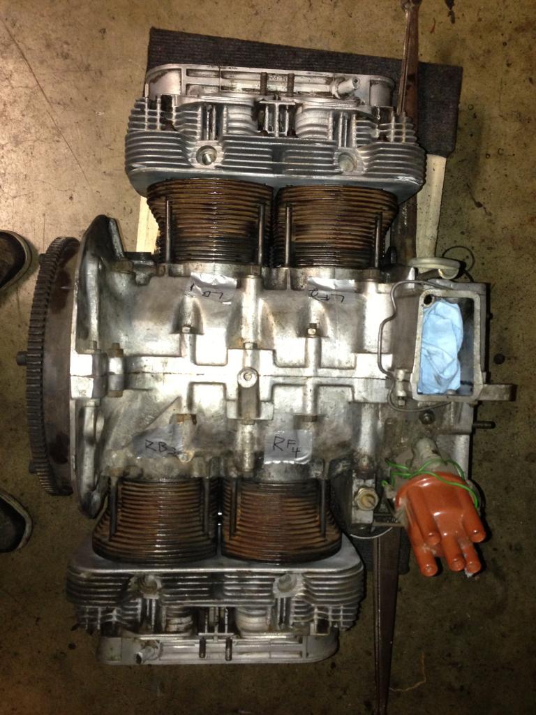

Tonight i got both heads put on and torqued down, I reused the head gaskets because the ones that came in the engine gasket set were too small. The old ones were in great condition, i cleaned them up a little and they looked fine to use. Cleaned up and rattle caned the deflectors and put those back on too. Then cleaned up the oil cooler a little bit so it was shinny again (IMG:style_emoticons/default/biggrin.gif)
(IMG:http://www.914world.com/bbs2/uploads_offsite/i1293.photobucket.com-14538-1367831763.1.jpg)
(IMG:http://www.914world.com/bbs2/uploads_offsite/i1293.photobucket.com-14538-1367831763.2.jpg)
(IMG:http://www.914world.com/bbs2/uploads_offsite/i1293.photobucket.com-14538-1367831763.3.jpg)
