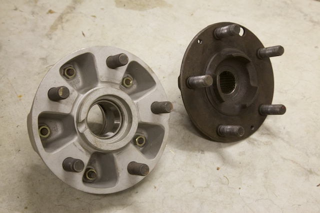

Need to remove these wheel studs. I've tried a C-clamp, without success. Thought about a BFH but that can't be right (right?). Any ideas welcome - thanks.

20 ton press...

QUOTE(Mike Bellis @ Nov 21 2013, 08:16 PM) *
20 ton press...
Or a BFH. I used one and it worked great. (IMG:style_emoticons/default/biggrin.gif)

QUOTE(Mike Bellis @ Nov 21 2013, 11:16 PM) *
20 ton press...
Your local automotive machine shop or repair station with a press can do it. I had rear hubs re-studded for $30.

u gotta compressor and a air chisel ?
use the drift point and air hammer it out, works on my one ton rotors.

Just did mine with the press yesterday, piece of cake.
Now the hubs are at the anodizer for refinishing, looking forward to see the result... (IMG:style_emoticons/default/drooley.gif)

The fronts can be pressed out pretty easily in a bench vice. Unless the rears are welded in, you should be able to put a steel lug nut on them and whack them out with a hammer.

Here's a link showing a tool available at Harbor Freight that can be used to press out studs:

You could try heating them in an oven for a while then hitting them. 200* would be safe
