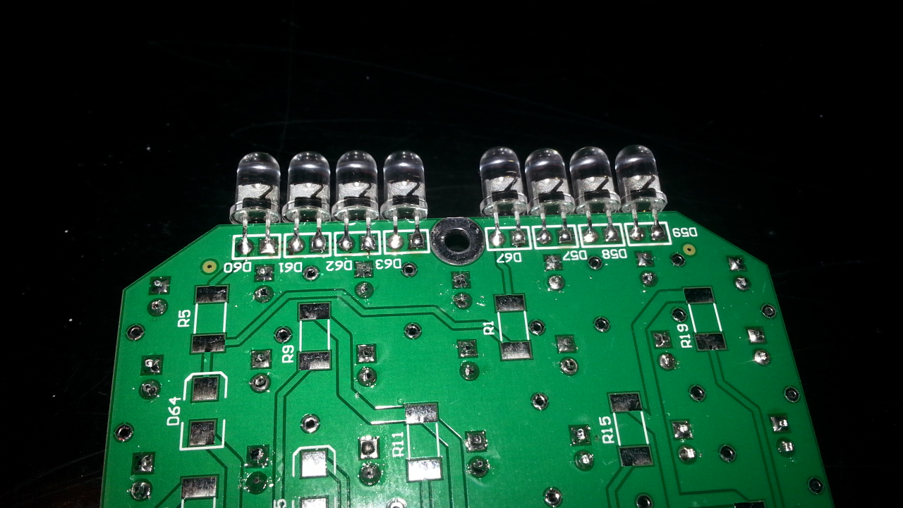

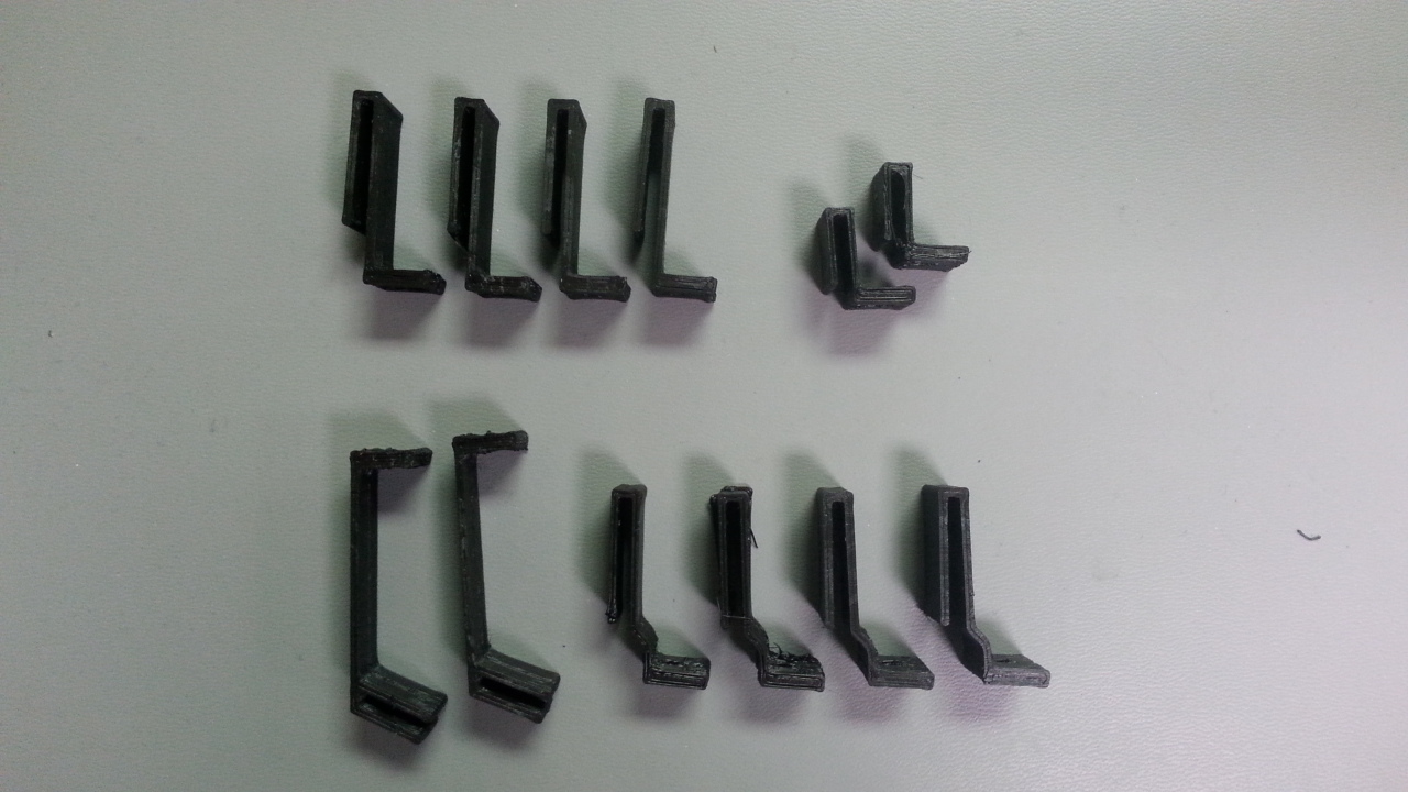

Updated the clips again. The inside turnsignal clips were modified with a slight bend to better fit the contour of the reflector housing. The small clips for the brakes were also changed a bit. The perch of clips were angled an additional 3.5 degrees to better match the board angle.
Also the clips are now in black because black looks cool.
The boards were updated to fix a few issues with the rev 2 boards. First the rev 2 boards were a bit too long given the thickness of the plastic clips. So the rev 3 boards are now 35mil (0.9mm) shorter.
Also the side facing LEDs on rev 2 interfered with the lens posts. On rev 3 the LEDs are pushed side by side to clear the lens posts.

The 3D printed plastic clips allow the boards to settle deeply enough to clear the lens.
(IMG:http://www.914world.com/bbs2/uploads_offsite/i142.photobucket.com-1239-1400060777.3.jpg)
While I did not deal with the metal clips, I can add that I had very little difficulty adjusting the plastic clips to get a correct fit.
