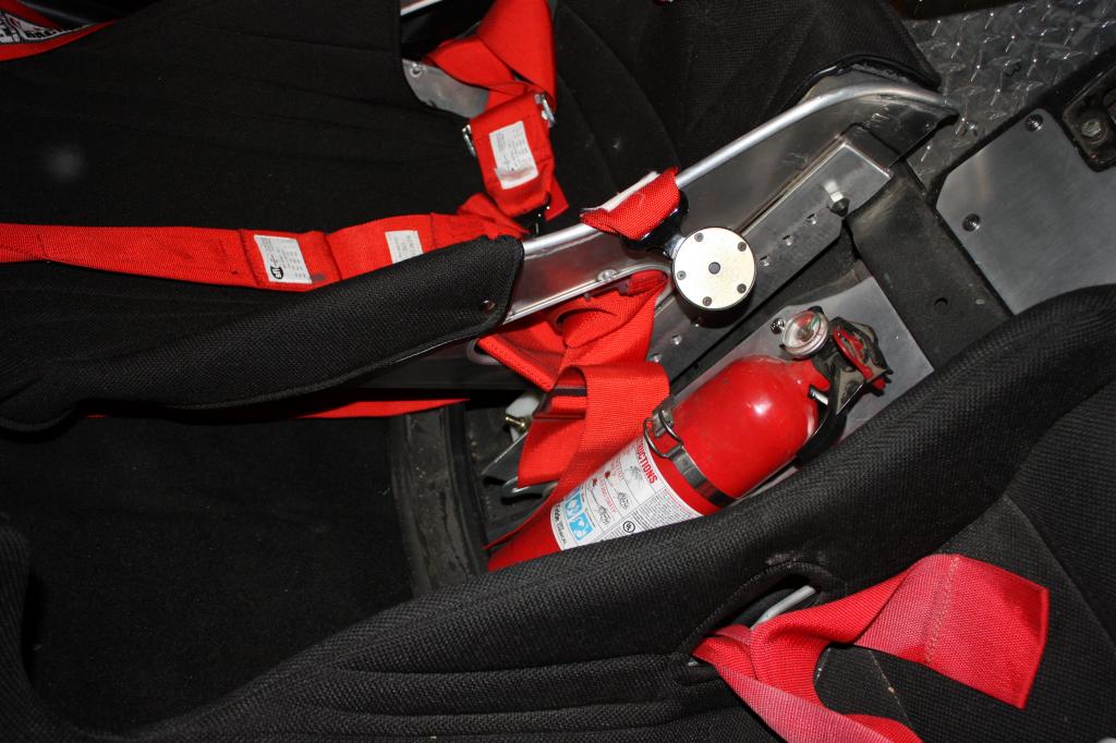

Some will attach them to the front of the pax seat, or to the seat rails or the crossmember.

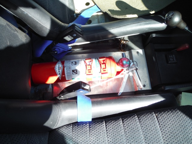

I bent up an aluminum plate to go where the center tray went, and drilled it for the extinguisher mounts.

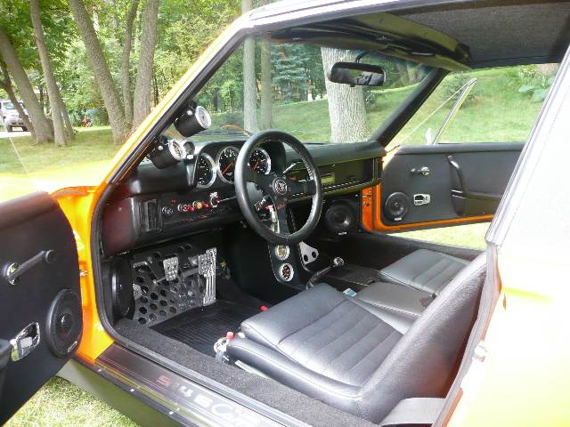

I did't have a center console so, I mounted forward of the shifter on the tunnel. I've seen them mounted cleanly next to the console on the passenger side, but it did take up a little foot space. The main thing is to mount it where you can get to it the fastest...

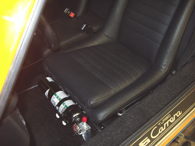

iamchappy
post Jun 5 2014, 09:18 AM
It all happens so fast!
Posts: 4,893
Joined: 5-November 03
From: minnetonka, mn
Member No.: 1,315

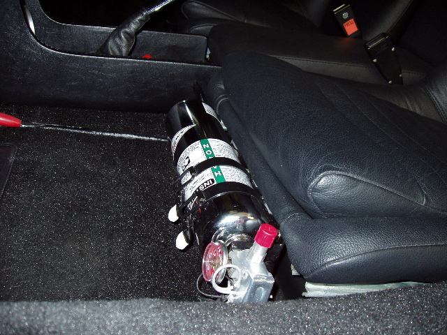

I made a bracket that mounts it on the front of the drivers seat that works well as a location.

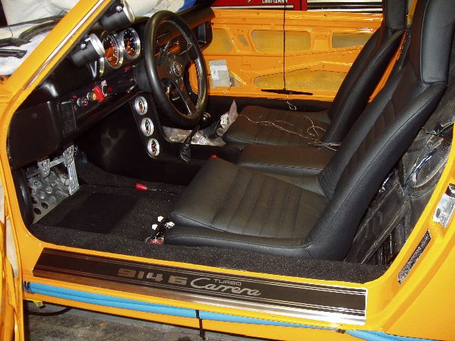

QUOTE(iamchappy @ Jun 5 2014, 08:18 AM) *
How did you do those sill plates?
iamchappy
post Jun 5 2014, 09:35 AM
Posts: 4,893
Member No.: 1,315
I had a guy make them for me, i believe he sold custom thresholds either in the vendors area here or it was Ebay.
Dave_Darling
post Jun 5 2014, 10:33 AM
914 Idiot
Posts: 15,335
Joined: 9-January 03
Member No.: 121

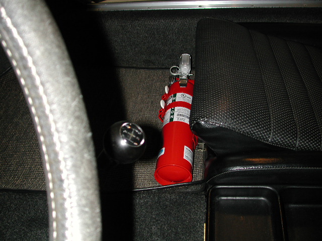

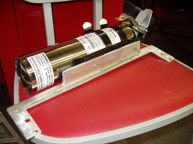

OK, I got a chance to take some pics.
Here's an overall shot. Note that the plate only goes back to just aft of the visible seam in the seat material.
Here's a closeup of the front part of the plate. It has a simple 45 degree bend and bend back to flat. I drilled the holes to match with the holes where the center tray mounted, and re-used the screws from the tray.
That's all there was to it.
Hmm, I gotta get the extinguisher re-charged, don't I?
--DD

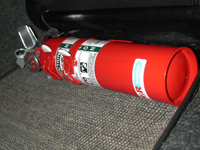

I've got a set of Coco Mats (Sisal) and they're very heavy. I just placed my extinguisher under the trailing edge of the passenger side mat, wedged by the front of the passenger seat. It doesn't budge in all kinds of driving.

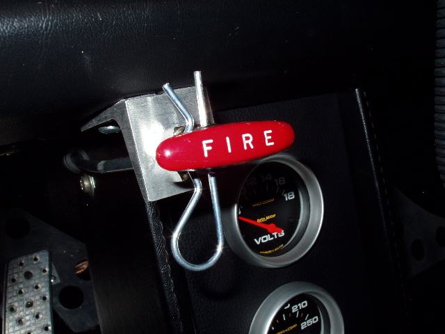

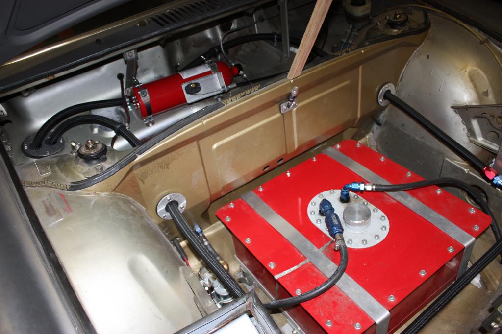

stugray
post Jun 5 2014, 07:35 PM
Posts: 3,825
Joined: 17-September 09
From: Longmont, CO
Member No.: 10,819

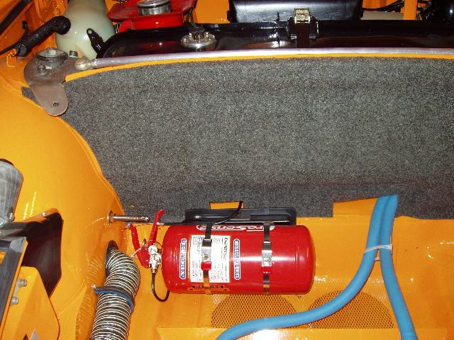

(IMG:http://www.914world.com/bbs2/uploads_offsite/i366.photobucket.com-10819-1402018530.1.jpg)
(IMG:http://www.914world.com/bbs2/uploads_offsite/i366.photobucket.com-10819-1402018530.2.jpg)
The system has three nozzles. Fuel cell/pump, Drivers crotch, engine.
handheld bottle is for something not sprayed by those three (like someone else's car)

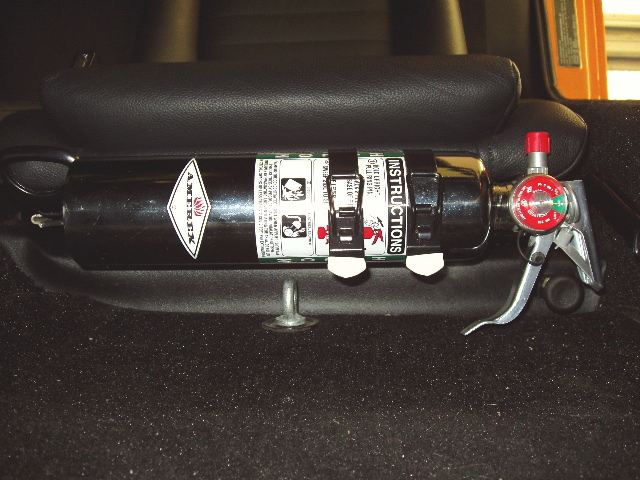

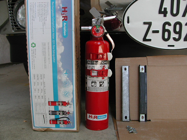

1970 Neun vierzehn
post Jun 5 2014, 07:54 PM
Posts: 3,199
Joined: 16-March 06
From: cincinnati, ohio
Member No.: 5,727
1 Halon F/E (from an civil aviation store) + 2 license plate magnets (from a car dealer) are mounted very securely to the front of the passenger seat cross member. No drilling, easy to reach, don't interfere with the driver, and do not move under hard braking or cornering (hard acceleration with a 1.7 is a moot point (IMG:style_emoticons/default/laugh.gif) )
Paul

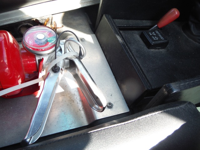

QUOTE(bandjoey @ Jun 5 2014, 04:39 PM) *
Uh. Dave. In case of fire do you get the zip tie cutter from the glove box or trunk?
They're attached to the ends of my arms. Finger through the hole in the pin, and twist. The zip-tie will break. At least, it will if it's my car on the line!!
--DD
Elliot Cannon
post Jun 5 2014, 10:39 PM
Group: Retired Members
Posts: 8,487
Joined: 29-December 06
Member No.: 7,407
QUOTE(Dave_Darling @ Jun 5 2014, 09:14 PM) *
--DD
Good luck breaking that big zip tie. Your pressure looks to be a bit low as well. Time to have it serviced or get another one. (And cut off that zip tie). (IMG:style_emoticons/default/biggrin.gif)
