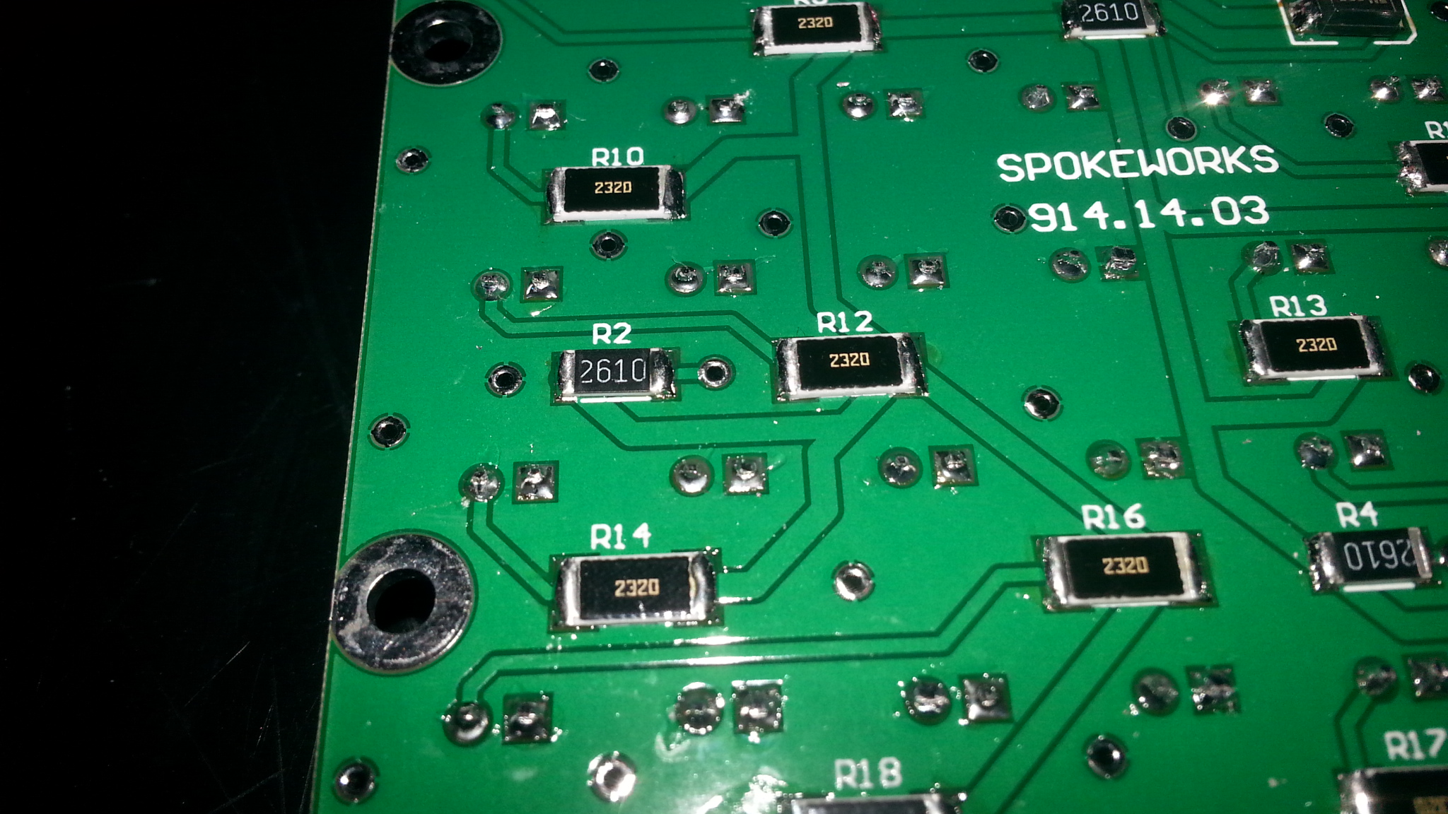

QUOTE(zambezi @ Jun 11 2014, 10:26 PM) *
Is there an "at home" remedy to cut the power to the turn signal LED's? I assume they are getting power from the side facing LED group. I think those being lit would be fine, but if we find the whole turn signal board being lit is a problem, is there a simple circuit we can disable to eliminate that function but still have the side LED's lit? Just asking because I installed mine today (even though the car is not yet ready for the road) and am seeing the same as everyone else. I don't have a problem with them yet but I have not used the car yet to see if it caused confusion with other drivers. I don't think any of the LEO's around these parts could care less about the legal issues of the lights, so that is not my concern.
It is pretty simple to disable the amber LED array from the running lights and still have the side facing LEDs. The side facing LEDs alone should bleed very little towards the rear of the car.
See the attached pic for resistor R2. Remove this resistor and the LED array is disabled from lighting with the running lights. R2 is easy to identify as it is smaller in size as the other resistors.
There are 3 basic ways to remove R2:
1) Using 2 solder irons, heat both sides of the resistor and remove. If you have a single wide solder iron, it may be possible to lay the iron so it contacts both sides of the resistor at the same time to remove.
2) If you don't have a solder iron or can't get the resistor removed with a solder iron, you can simply crush the resistor with a pair of pliers. It may seem crude but it will work. The resistor is constructed on an alumina ceramic substrate which will shatter if compressed with a pair of pliers. Needlenose would work best. Just clean up the resistor fragments after breaking it and you're good to go.
3) Ship the boards back to me. You pay shipping to me and I'll pay shipping back. I will reimburse your shipping cost since this was my mistake.
BTW, those with red LEDs should not suffer from this legal infraction as the red running lights will only make the light footprint of the car larger at night.

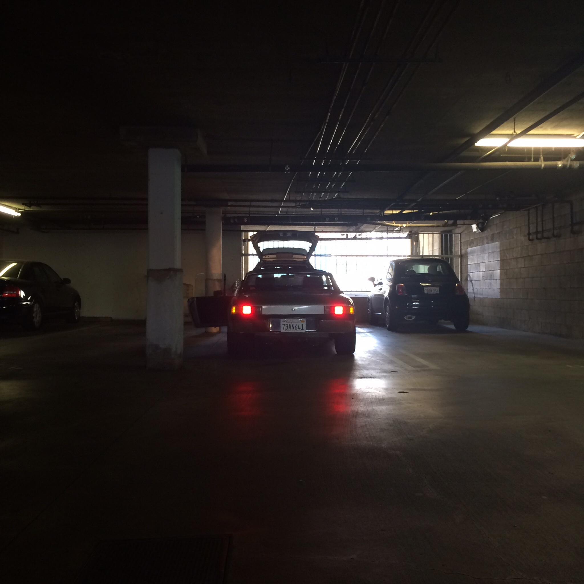

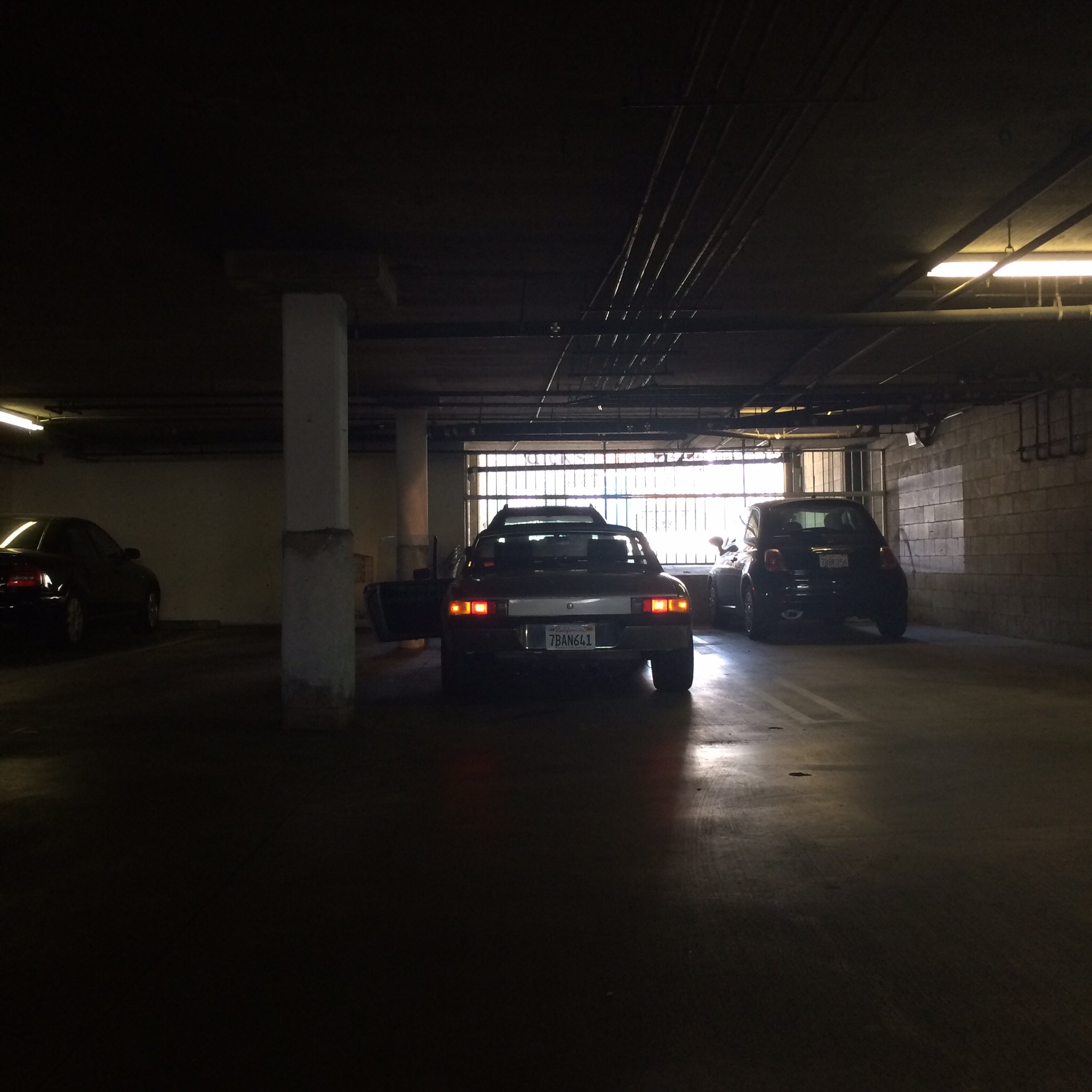

Finally my ladylike slender fingers come in handy...
Fitted these today, took me 15 mins - very simple install and the bayonets were a lot easier to put in than I thought they'd be (see previous ladylike finger comment). Overall, very happy with them. Great job Spoke.
Pictures were taken during the day in my parking garage.
Before:
After:
