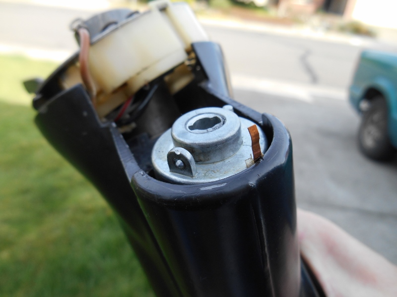

as mentioned before pumpkin is a 70, here is a pic. tumbler assy is out and this is top of switch. notice the loop (lack of better description) well there is a screw that goes from tumbler assy into that (holds it all together) you have to pull on whole assy to get it far enough out to see screw. we had to unhook the electric and pull it all the way out of car what a pita. hope pic helps

I had to pry the whole assemb;y off. If fit rather tight but that did it the key assembly now is out.
And for other questions it is a 73.
