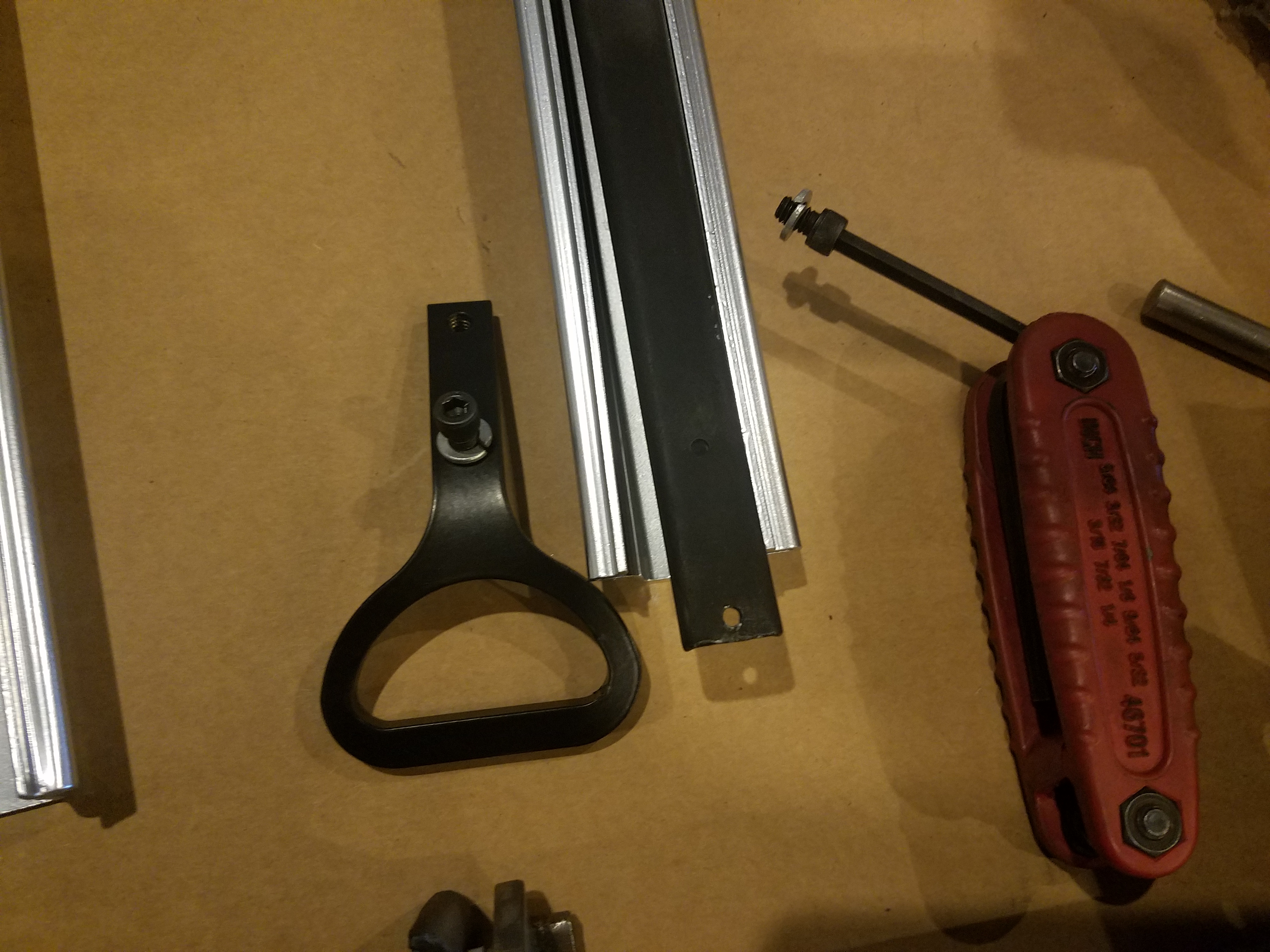

Question for those that have installed the 914Rubber handle: Do I need to drill the holes in the adjuster to a larger size or do the supplied screws fit in the factory holes?
Rob-O
post May 20 2018, 05:35 PM
Posts: 1,312
Joined: 5-December 03
From: Mansfield, TX
Member No.: 1,419
Ya been awhile since I installed them but I want to say I did need to drill a slightly larger hole and then assemble with nut and bolt. I don’t remember if the nut and bolt were provided by 914Rubber or not.
billsimmeth
post May 20 2018, 07:07 PM
Posts: 23
Joined: 3-May 12
From: Virginia's Blue Ridge
Member No.: 14,428
Thanks Rob,
Seems hardware is included. Just need to know hole size as car is leaving tomorrow for California and I'll need to install handle in the field.
QUOTE(Rob-O @ May 20 2018, 07:35 PM) *
914-300Hemi
post May 20 2018, 07:23 PM
Posts: 1,391
Joined: 7-September 06
From: San Dimas, CA
Member No.: 6,794
I just installed one. You have to make the hole bigger for the bolts that are provided with the kit. I would suggest replacing both of them.

Thanks guys. Anyone know what diameter the bolt that 914Rubber provides is?
Dave_Darling
post May 21 2018, 10:48 PM
914 Idiot
Posts: 15,335
Joined: 9-January 03
Member No.: 121
Avoid the plastic Weltmeister ones... They break about the second time you use them.
--DD
jcd914
post May 21 2018, 11:07 PM
Posts: 2,096
Joined: 7-February 08
From: Sacramento, CA
Member No.: 8,684
I did not buy this one, it came with one of the cars I bought but I don't know of anyone else that makes metal ones other than 914rubber.
It has 6mm Allen head bolts with lock washers, so a 1/4 inch drill will work.
Jim

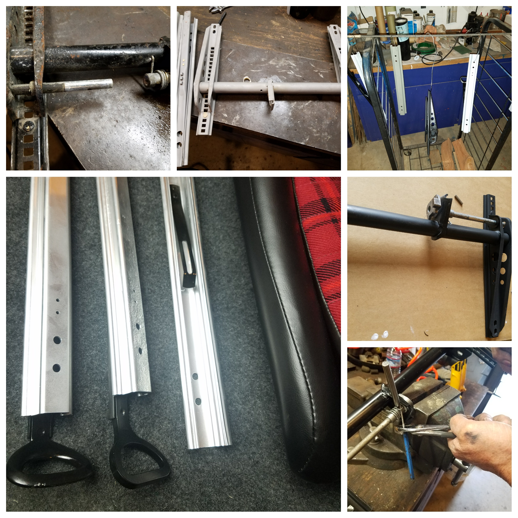

I restored the base while I had it out and also replaced the seat adjuster bushings. https://shop.914rubber.com/Seat-adjuster-re...4?categoryId=-1
Matty900

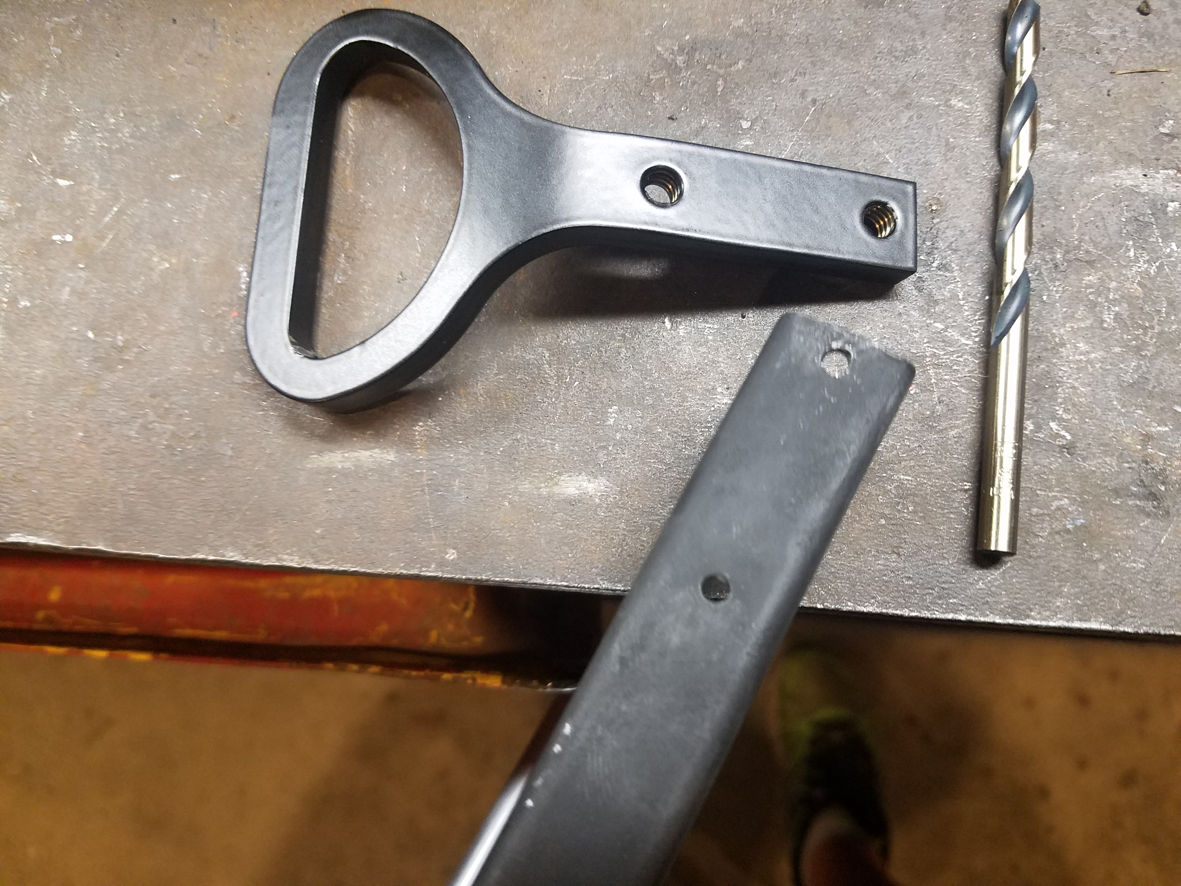

Drill out the broken handle. (I think it was 7/32)
Matty900
post May 22 2018, 01:49 AM
Posts: 1,302
Joined: 21-February 15
From: Oregon
Member No.: 18,454
Then screw on the new one.
