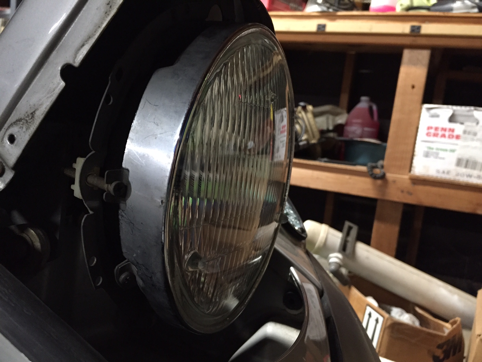

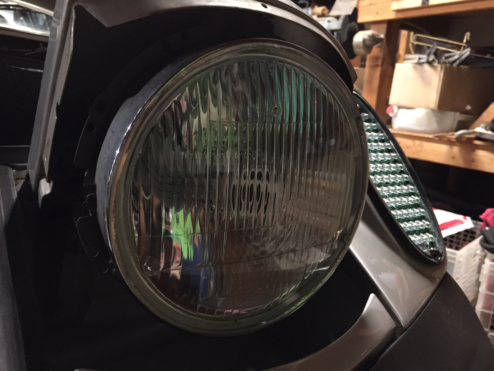

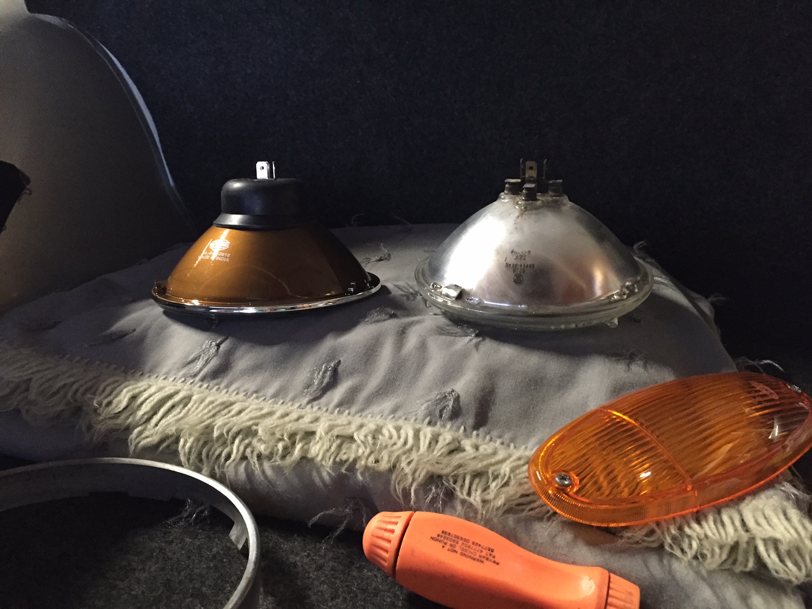

Well I can answer one question--They DO fit. I didn't have my keys with me out in the garage last night so I could not test the actual function of them, if they require re-wiring its a deal breaker, I'm only interested in pure plug-n-play...still optimistic.
Pics of the fit:
LED light on left, OE on right
Ignore my original equipment dirt, I'll clean once I know it works. New light fitted, nice and 'flat'

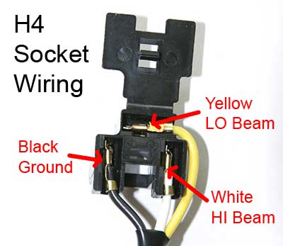

QUOTE(eric9144 @ Jun 24 2016, 10:35 AM) *
If your 914 is wired correctly as it left the factory, they will work just fine.
If someone has switched the ground wire location, they will need to be corrected back to factory wiring.
I cant stress this enough.
Back side of the female H4 plug.. (black would be BROWN) = Ground wire.
After you test them out at night, let me know how you like them.
Cheers- Thomas

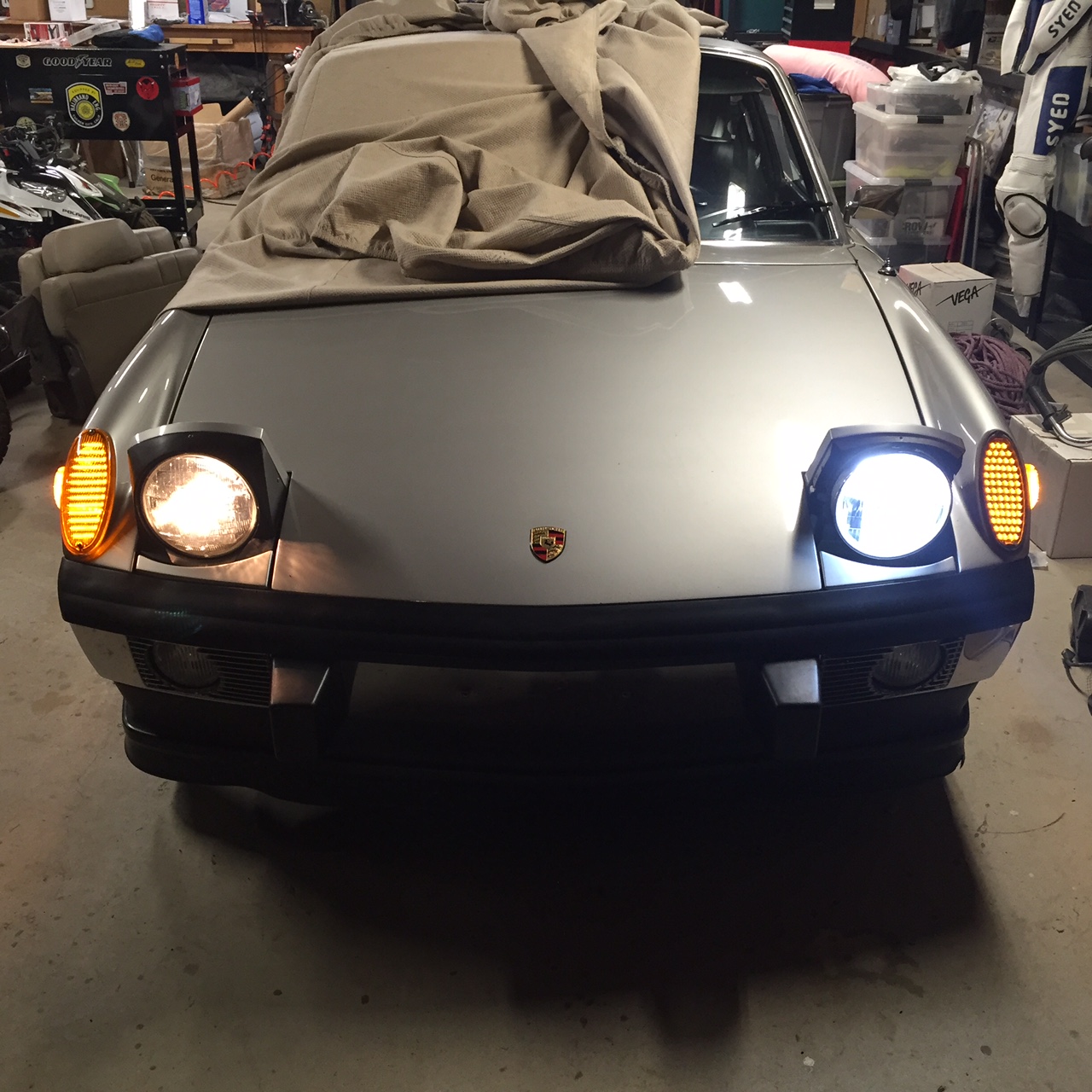

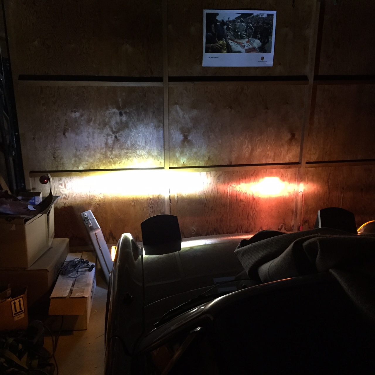

Finally grabbed my keys and went back to the garage to test and... They are TOTALLY plug and play, only thing I may have to do is slightly adjust the beam height (down) but pretty good at install. Only had done the one to compare:
