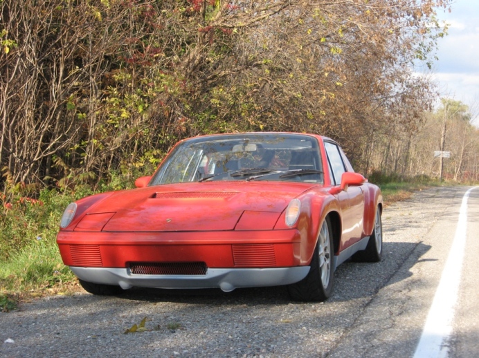

Previously completed a Chev V8 conversion and used a 5 speed Boxster tranny with cable shifter. It was a 300 HP motor and worked well with the Boxster tranny, other than the top speed was limited to 130 MPH because of gearing and the 6,000 RPM from the engine. It was lots of fun for a street car. AllanAttached Image

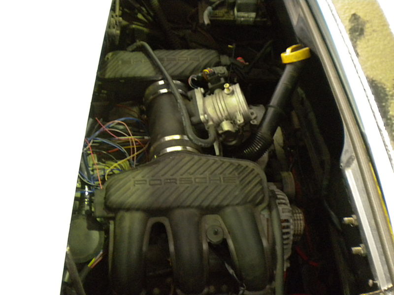

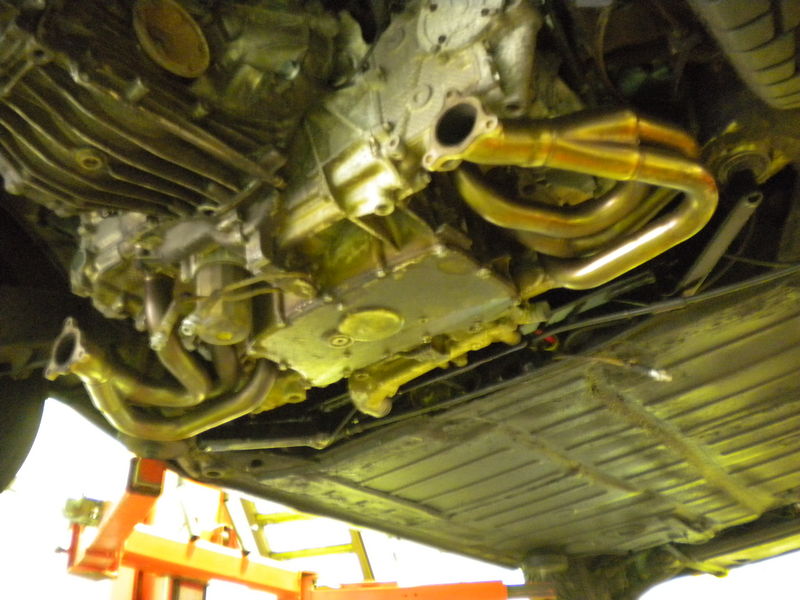

Here are pictures of a running car in Aussie. Go to the end of the thread
914with boxster engine

Very interesting. The intake is flipped and the throttle body is turned 180 degrees. Fits pretty good and the intake is nice and tall to clear the alternator.
Nice headers!

That's a lot of engine in there.....
