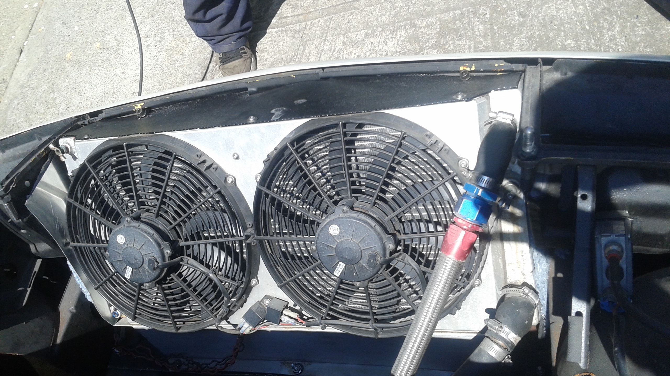

QUOTE(BRAVE_HELIOS @ Aug 24 2016, 03:50 PM) *
Almost ready to take things apart one more time. So how crucial is it to use wye connectors versus Tee connectors? I spotted these on amazon (see picture):
https://www.amazon.com/Water-Temp-Joint-Pip...+Sensor+Adapter
And it would be much easier (and cheaper) for me to install the correct sized NPT barbed nipple to this adapter versus getting a custom wye connector.
I found it much easier for me to get stainless pipe the diameter I needed, weld up the connections I needed. I welded up quite a bit more than I thought I would and actually want to do more. It was simple with stainless wire and a mig.

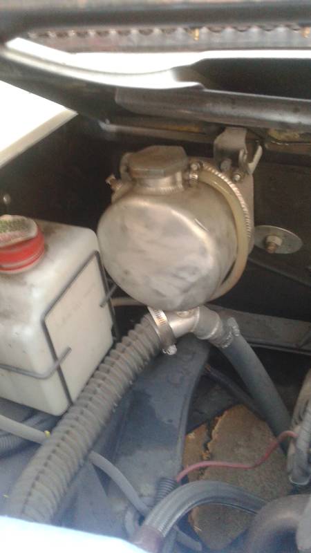

Slowly progressing.
Quick question; which part of expansion tank must be above the block (t-stat?)... the bottom (low pressure) hose or the upper (high pressure) hose? Does it matter much Death Star or Passat expansion tank?

Andyrew
post Aug 28 2016, 04:41 PM
Post #84
Spooling.... Please wait
Posts: 13,380
Joined: 20-January 03
From: Riverbank, Ca
Member No.: 172
That upper hose. Either of those mounted in that position will work. I prefer the non rounded version, but they do fail occasionally. Thats what I run.
veekry9
post Aug 28 2016, 05:33 PM
Post #85
OldMember
Group: Retired Members
Posts: 3,068
Joined: 17-June 13
From: TO
Member No.: 16,025
Not less than N.
The method to calculate the size of cooling system expansion tanks,and the 'why' of the radiator having a smaller return hose.
The total volume of the system is larger than a pickup or van,so,not less than the size of tanks installed in them.
http://www.engineeringtoolbox.com/volumetr...sion-d_315.html
A small 4 cylinder's expansion tank is smaller for that reason,not equal,not the same size as a pickup's V8 tank.
Placing the tank below the head is ok,in a pinch,as the level is controlled by the pressure cap,tho level is desirable.

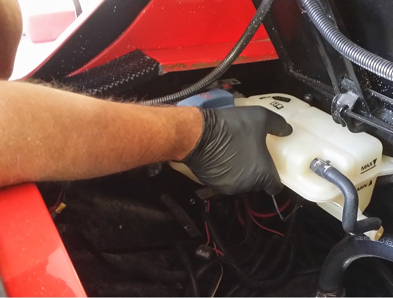

BRAVE_HELIOS
post Sep 18 2016, 05:58 PM
Post #86
"Knowledge speaks, wisdom listens"
Posts: 295
Joined: 25-September 06
From: The Land Of ID!
Member No.: 6,920

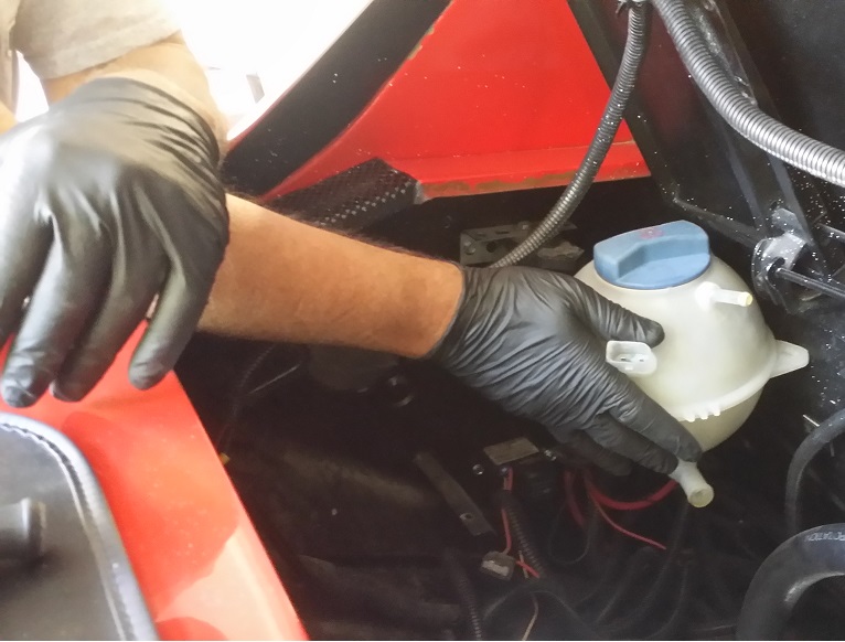

Here is a picture of the completed setup. Still trying to get the air out of the system. Loosened the petcock on the top side of the rad and nothing... no air and no fluid. Pictures do not show the addition of a overflow tank placed in the trunk.
So; if I do not have a vacuum pump... what is the best way to purge the system of all air?

QUOTE(BRAVE_HELIOS @ Sep 18 2016, 04:58 PM) *
Engine should be running. Hot air/water makes its way to the top thin line and feeds its way to the reservoir. Then your large line is your feed back into the cold side of the coolant line.
Basically running the engine will purge the system, aka self purging.
Chris H.
post Sep 19 2016, 12:16 PM
Post #88
Posts: 4,079
Joined: 2-January 03
From: Chicago 'burbs
Member No.: 73
Yes just fill the system up and run it through a couple of heat cycles. Make sure it's all sealed up so that the system is pressurized. Put the blue cap on and make sure all the hoses are attached just like it would be if the car was 100% ready to drive. Although it may seem logical to leave a line open, it keeps the system from forcing the air out. Rev it a few times the first time to make sure your thermostat opens and feel the line going to the radiator to make sure they are hot. Watch the temp needle (at least the first time) for spikes in case you have a big air pocket. Get the engine up to temp and then shut it off. Then..(the hard part)....leave it alone and let it cool off completely. When you check the coolant the level should be down a quart or so. Maybe more. A couple more like that and you should be good. In fact once you know that you don't have any serious bubbles you can drive it around a block or two. Then very quickly you won't have to add any. BTW I never got anything out of my radiator bleeder either. Probably would now but the system is bled.

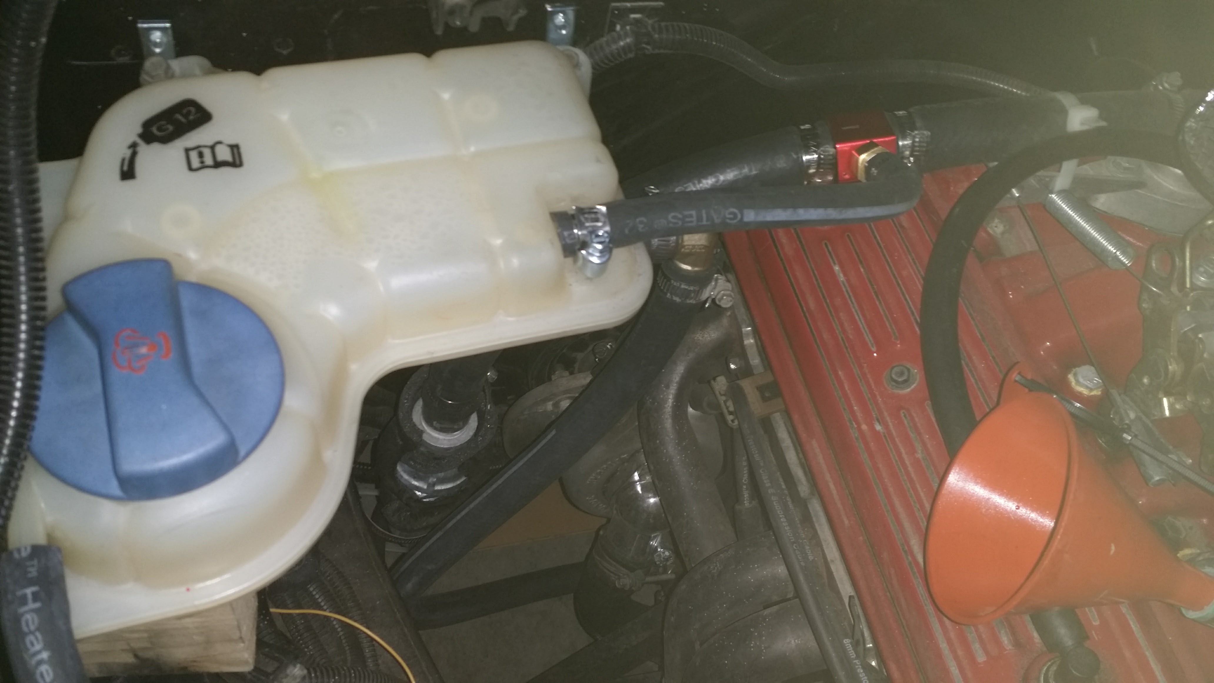

An update (pictures to follow);
I have the system all together and I thought it was going well. I took it for a drive at around dusk where the ambient temperature was 67 degrees and the car only got up to around 190 degrees. This is a marked improvement considering that in the past; even on a 40 degree day, the engine temp would go past 200. Well; last night, I let it idle in the garage to see what would happen and it overheated. I mean the temp got up to around 230 and the coolant was boiling over in the overflow tank. Also the fan never came on (it is supposed to come on at 180). I did check and the fan does work. I shut it down immediately and let it cool off. As it cooled, it sucked up the coolant out of the overflow tank and back into the expansion tank and engine.
Prior to this; I tried to bleed the system. I lifted the rear end which lowered the rad and I did end up getting fluid to come out of the rad bleed petcock (upper corner of rad). I also mended the holes I drilled in the rad shroud.
After the boiling coolant episode, I noticed that no coolant was coming out of the rad bleeder.
I do have a setup where lines are coming off the main rad hoses and going to a heater core for cabin heat, and the day I took it out; I had good heat in the car too.
How much air can be in this system? The temp sensor for the fan is located by the t-stat. Is the reason that the fan did not come on because of an air pocket located by the temp sensor? I guess I really need to understand how the vacuum/manometer etc… system works and how to set one up for my system.
Any other suggestions?

Do you have a manual over-ride switch for your fan ?
On my system I have a manual switch for the fans, I usually turn on the fans when the temp reaches 180 degrees
I would install a on/off switch to control your fan, refill the system, start and bleed the system again.
You must have a running fan when stationary.

Put one of these powering a 12ga wire and a relay to control your fans. Put the probe in the radiator fins.
https://www.amazon.com/gp/aw/d/B00K75QRZA/r...&ref=plSrch
You need to have the system purge a couple times in order for the expansion tank to functuon correctly.

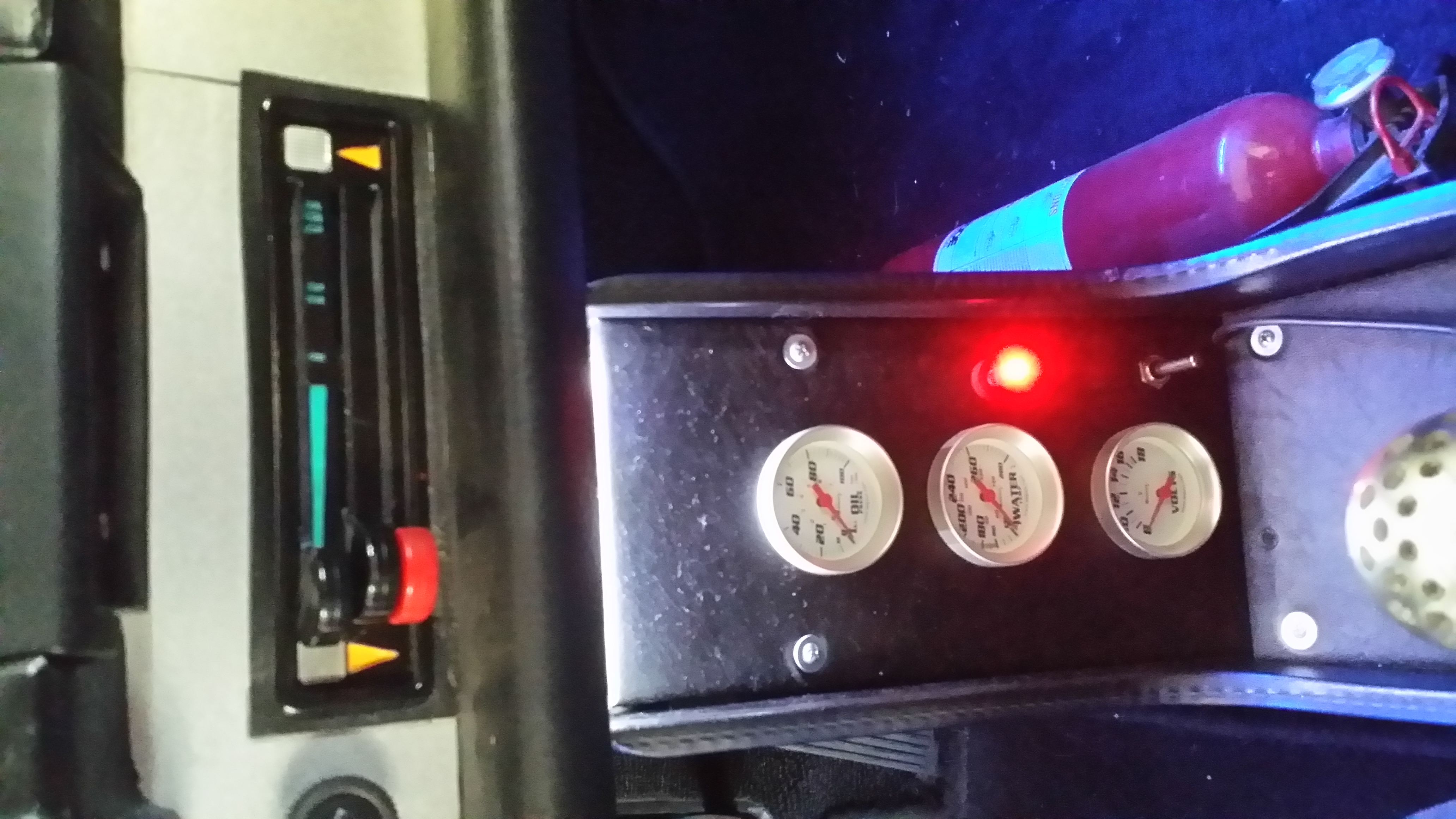

I do have a manual switch. It is located on the center console, to the right of the temp gauge. It also has a 160 degree t-stat installed with many small holes drilled around the flat surface. I am trying to avoid going to an electric water pump, but it is heading that way, it seems. I think I will remove the t-stat and replace it with a re-stricter washer and see what happens.
