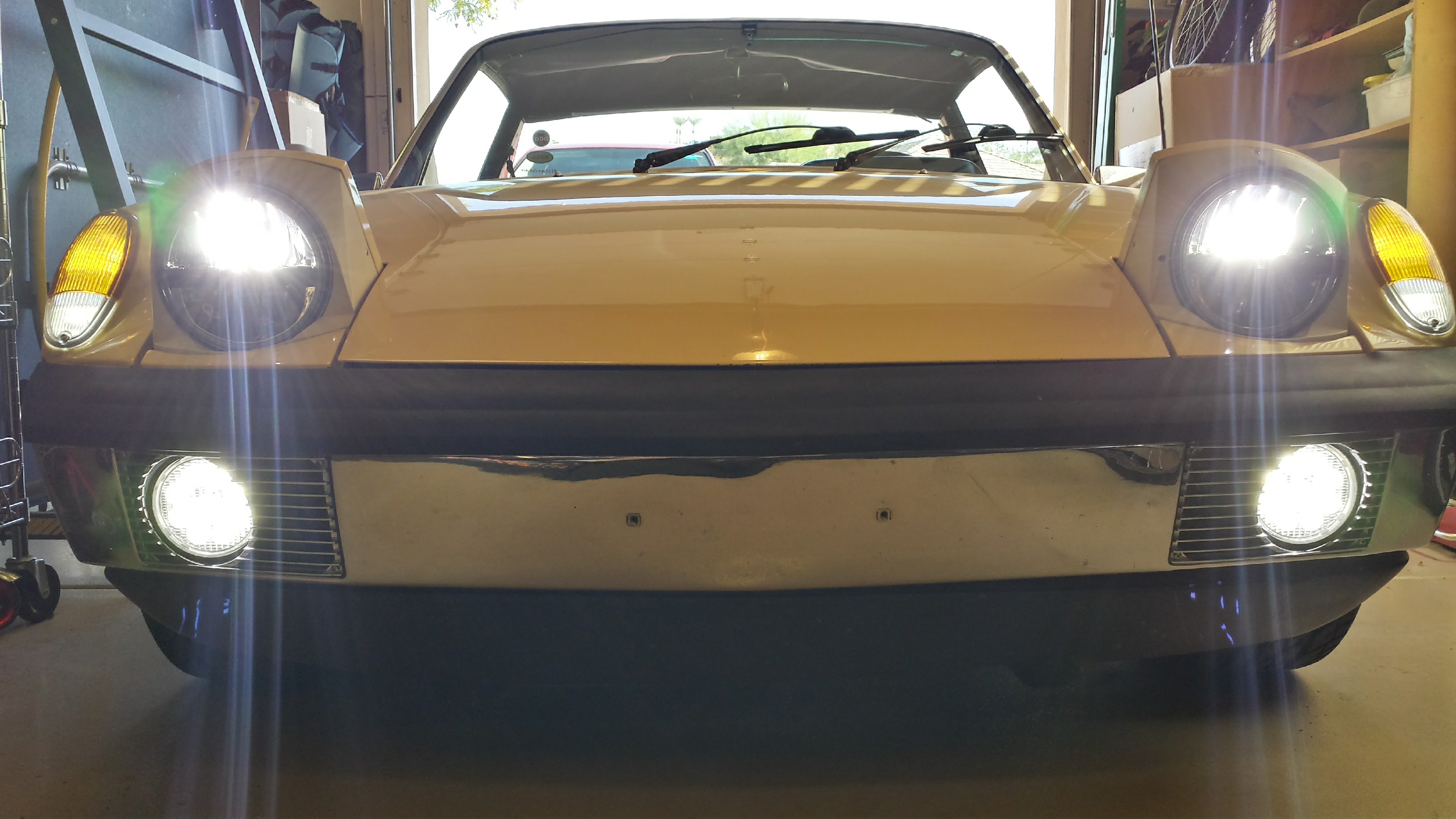

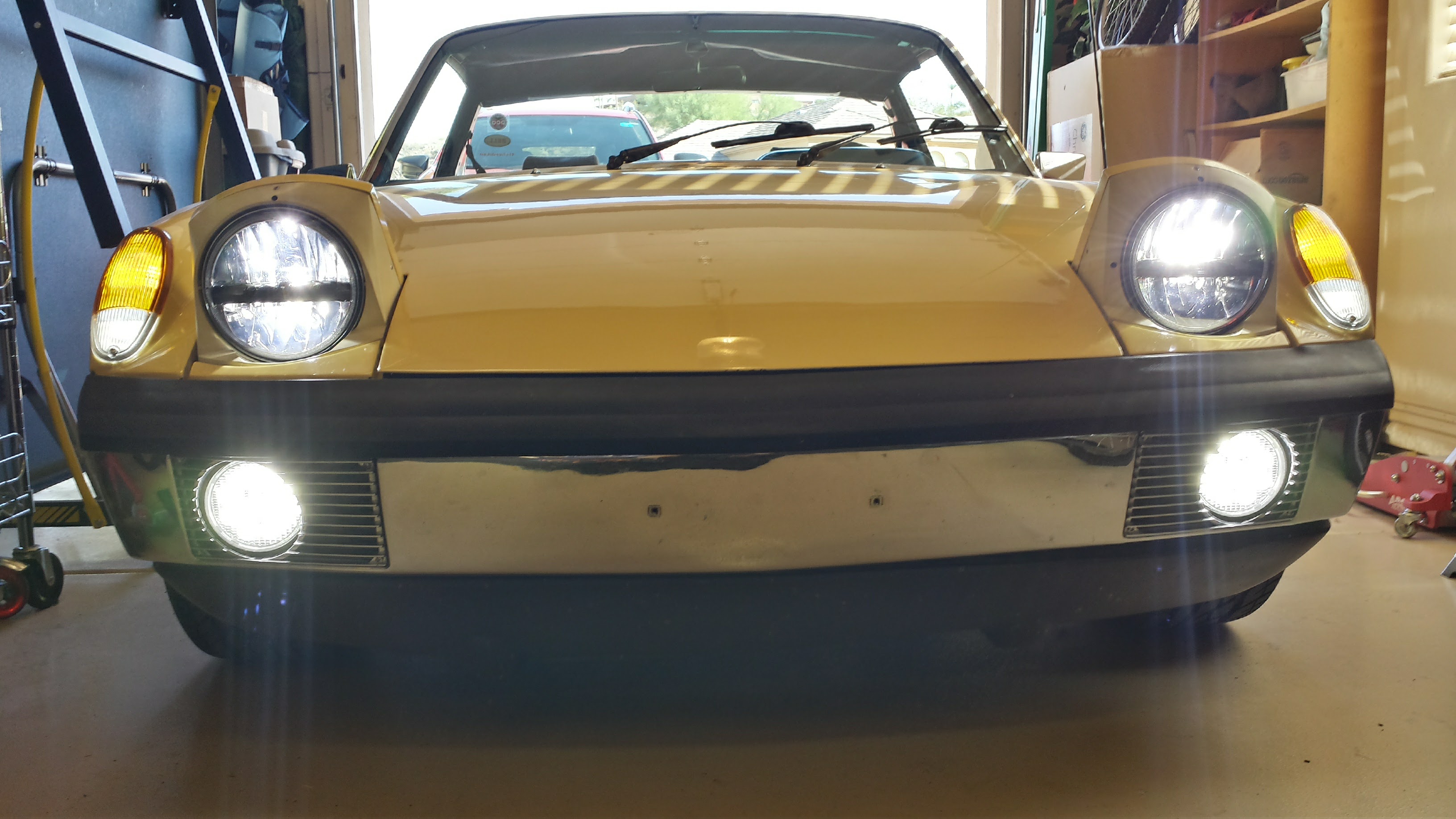

Just for a quick comparison, Here is a Vanagon user (I dont have any 914 photos) of the before/after beam compairison.
Also, keep in mind he is using our VC3500 kit.
If a 914 guy is able to send me some before/after photos I would love to put that on our website!
Source:
Vanagon Geek
(I think his high beams are on? Not sure, he didn't specify)
(IMG:http://www.914world.com/bbs2/uploads_offsite/3.bp.blogspot.com-20065-1475586650.1.JPG)
(IMG:http://www.914world.com/bbs2/uploads_offsite/4.bp.blogspot.com-20065-1475586650.2.JPG)

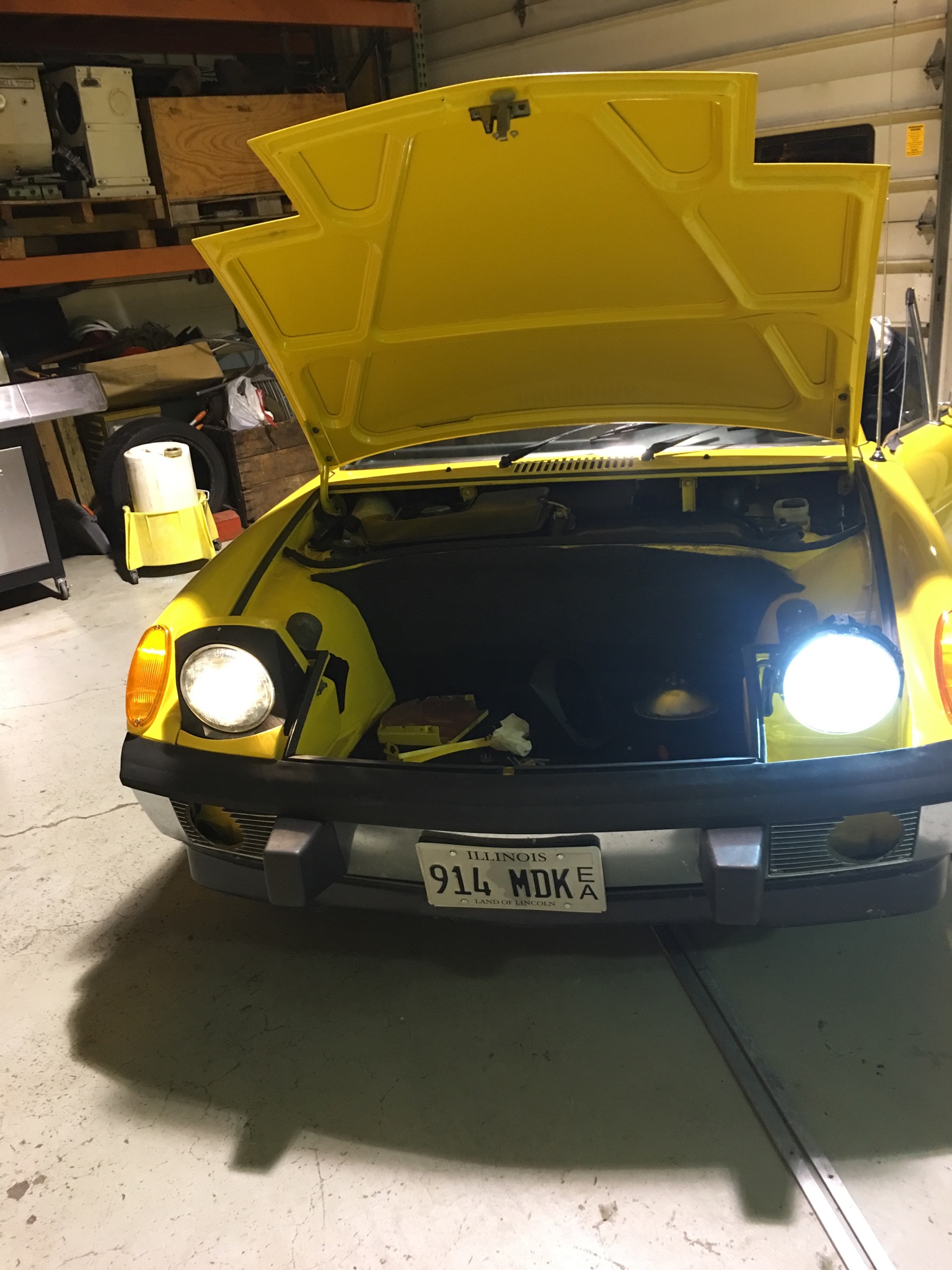

Can you tell which one is LED?
There is something missing in my purchase.
the buyers remorse is missing LOL
