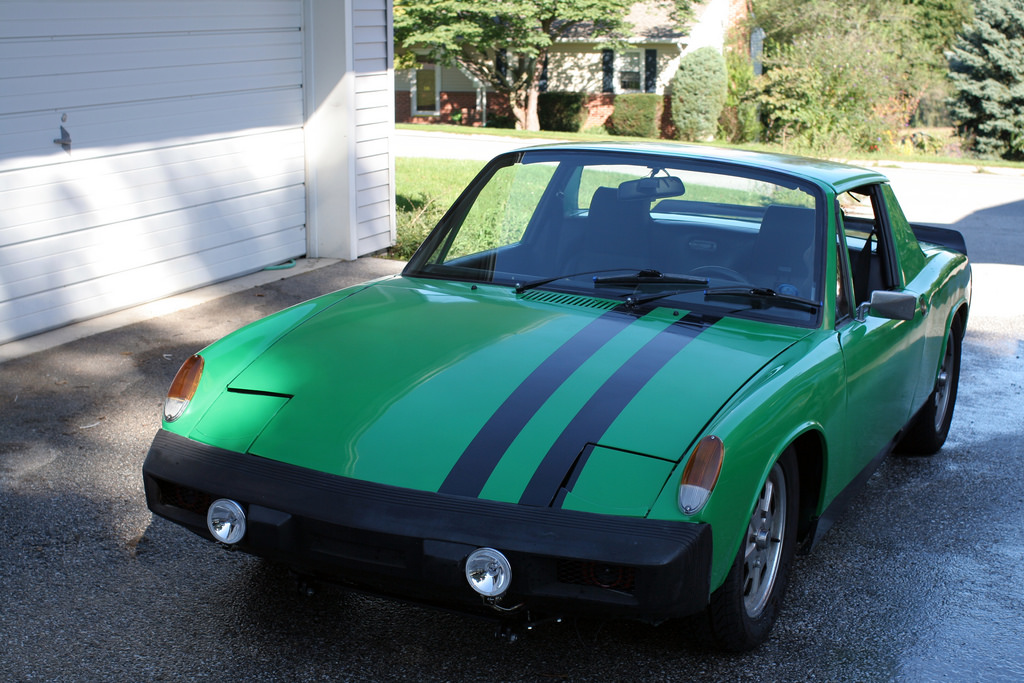

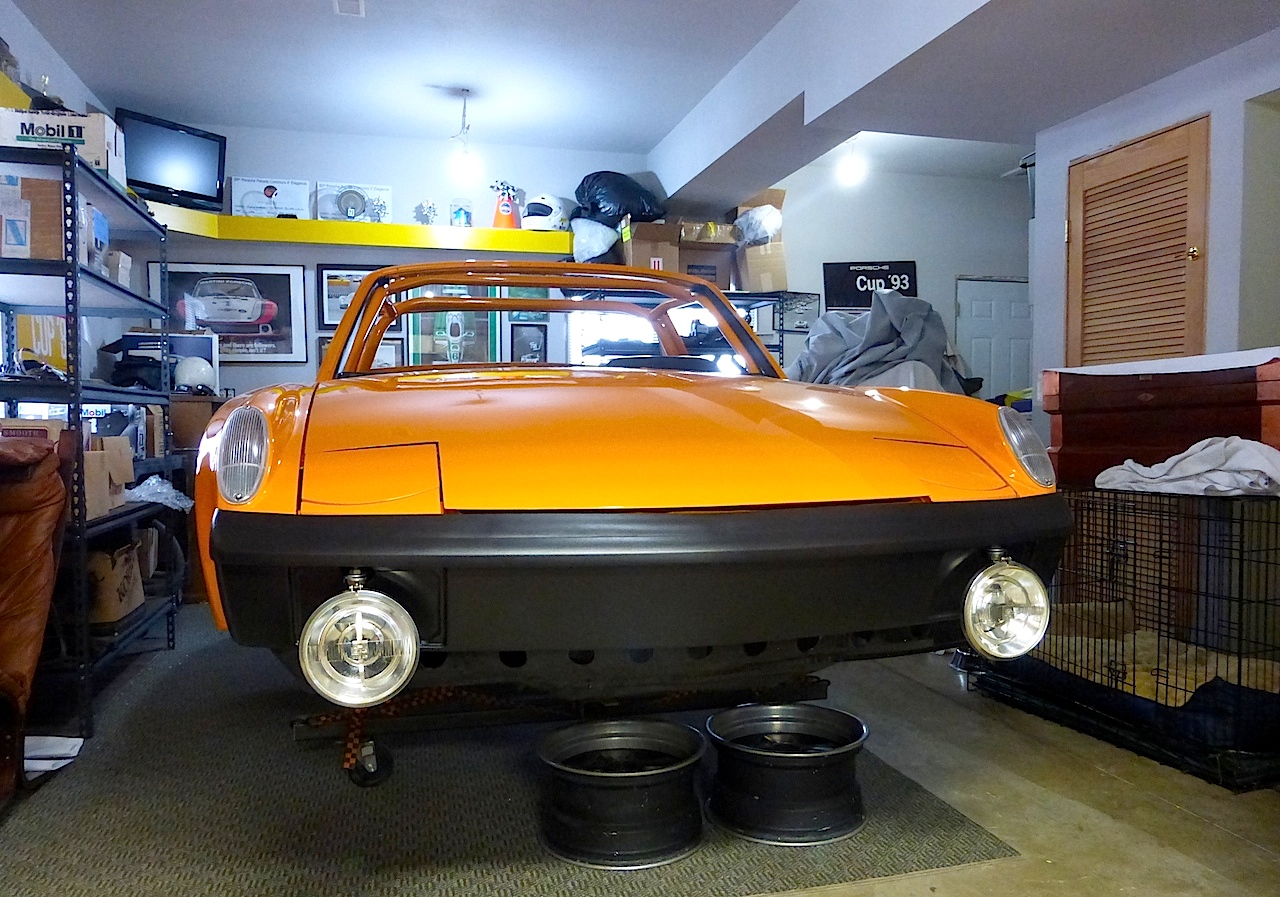

Pop-up delete. Just added driving lights up front. Best, MarkAttached Image

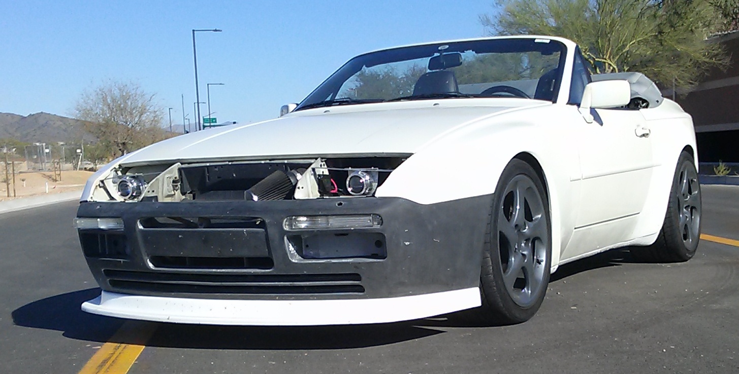

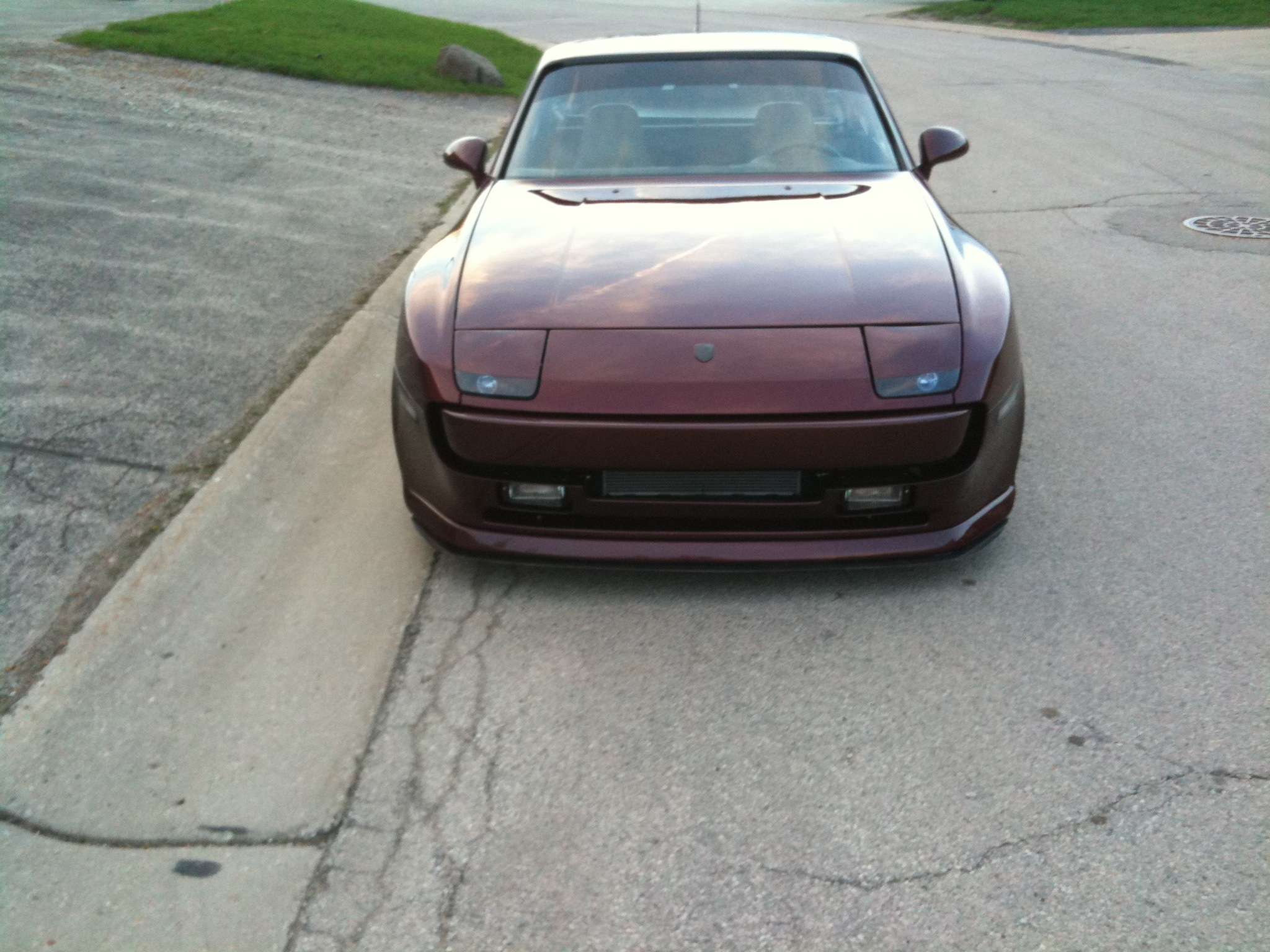

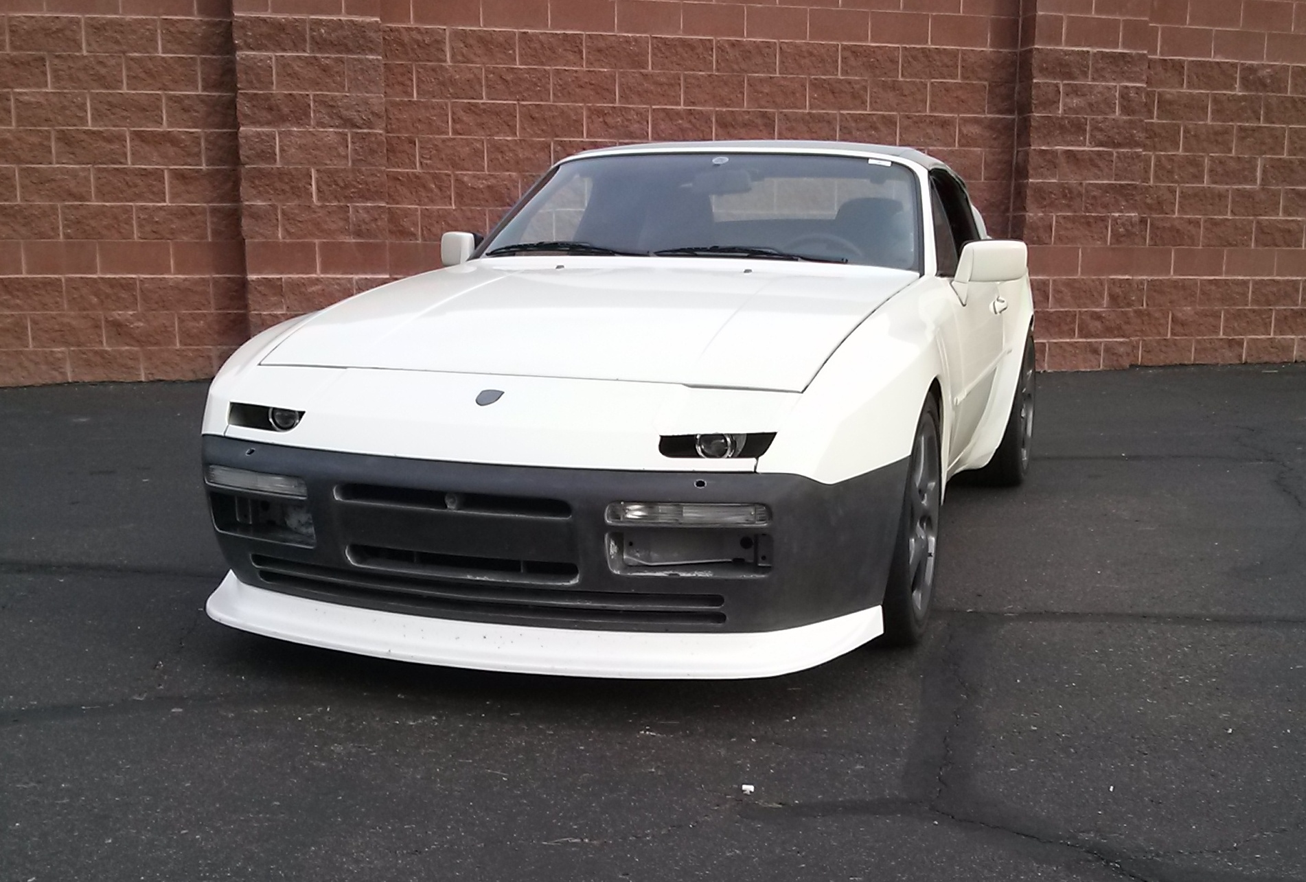

I've been working on something similar on my 944 Cab.
The burgundy car was my inspiration and the white one is my work in progress.

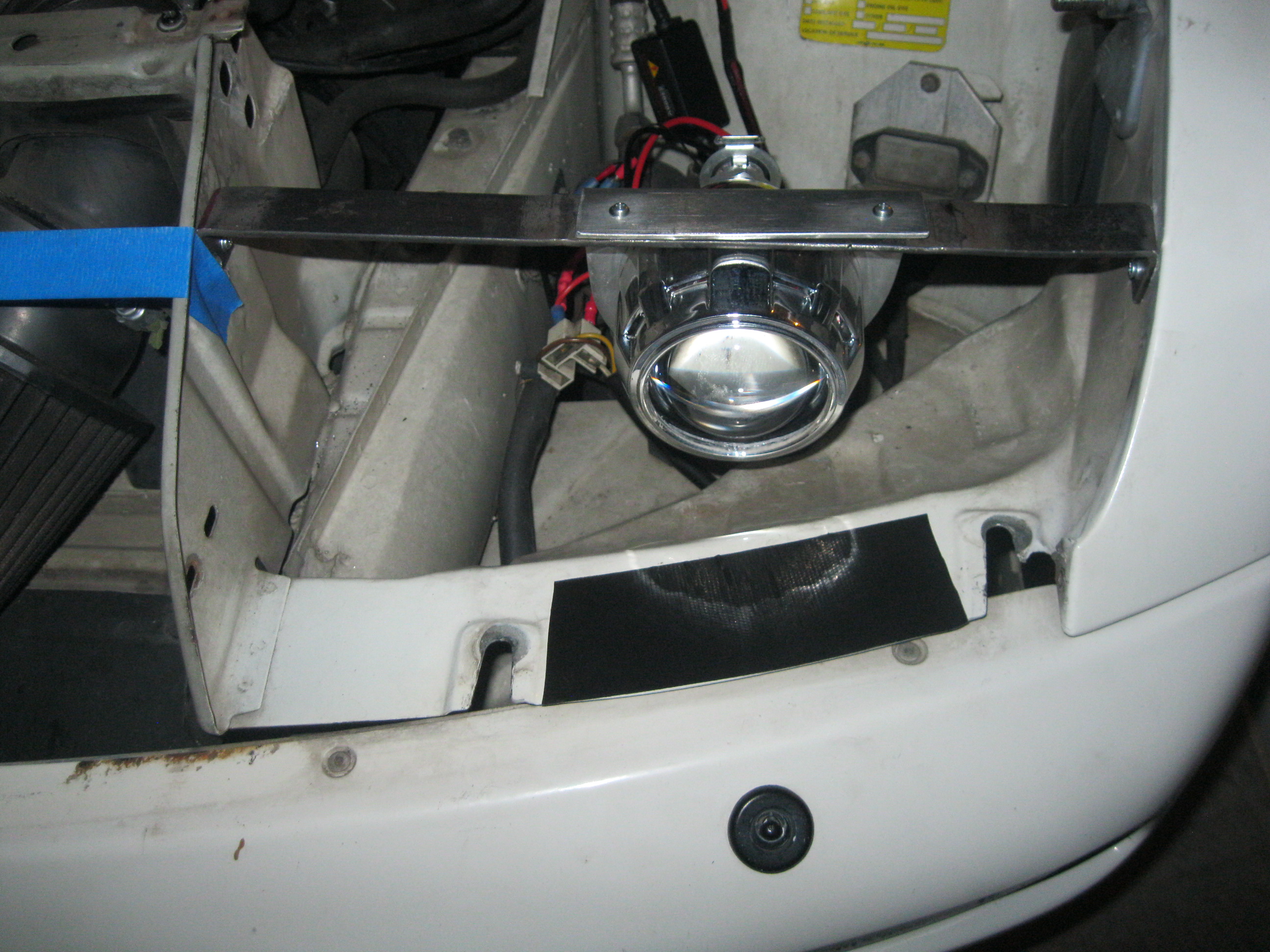

Here is s shot with a better view of what I am doing.
I have thought of making this a kit for the 944. I could build up something similar for the 914.

I can tell you that if you put driving lights or headlights on your bumper, you _will_ need to treat them like high beams.
I had so many people flash me for using my driving lights. The low placed lights reflect up off the road and blind oncoming traffic. These days I treat them just like high beams and don't use them if there opposing traffic.
If your head lights are low on the bumper, and you don't have any higher placed lighting options, you are going to piss off traffic and eventually get noticed by the police. Your state may have ways around this (if you are registered as a hot rod or kit car or something). YMMV.

I drove for 3-4 years with driving lights mounted in the fog location. Visibility was terrible with the lights mounted so low. Just went back to pop ups last year (LEDs) and couldn't be happier.
AZBanks
post Apr 9 2017, 10:42 PM
Post #37
Posts: 1,079
Joined: 7-December 05
From: New River, AZ
Member No.: 5,245
QUOTE(mgp4591 @ Apr 7 2017, 08:27 PM) *
QUOTE(AZBanks @ Apr 6 2017, 07:50 AM) *
The light looks pretty compact - where did you find them?
They were put together from two kits I picked up on ebay.
http://www.ebay.com/itm/H1-H3-H4-H7-H11-Xe...=item3f3699e08d
and
http://www.ebay.com/itm/271497426147?item=...123&vxp=mtr
I mounted the lights on aluminum brackets I made and mounted the brackets to steel supports I built.
The most challenging part was figuring out the wiring. The Projector headlights switch from low to high beam through the use of a little metal plate that blocks part of the light beam to create the low beam pattern. Voltage is passed to a switch that causes the plate to move out of the way for the high beam pattern. That circuit is completely independent of the circuit for the light beam itself. The entire operation and circuit structure is completely different than the operation and circuit structure of the factory lights. On the 944, the high and low beam circuits are completely separate. When the high beam circuit turns on, the low beam circuit turns off.
