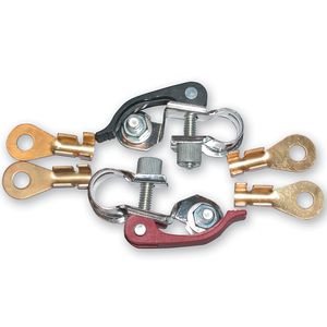

I've always used a lever type battery terminal clamp to be able to quickly disconnect the battery. I usually only use it on one lead to break the circuit. I've used the lead style ones over the years but on the most recent installation use this steel style. I was skeptical but ffor 3+ years its been working fine.
quick connect terminal
I don't like the disconnects shown in post #2 because they are too tall and frequently cause clearance issues.
