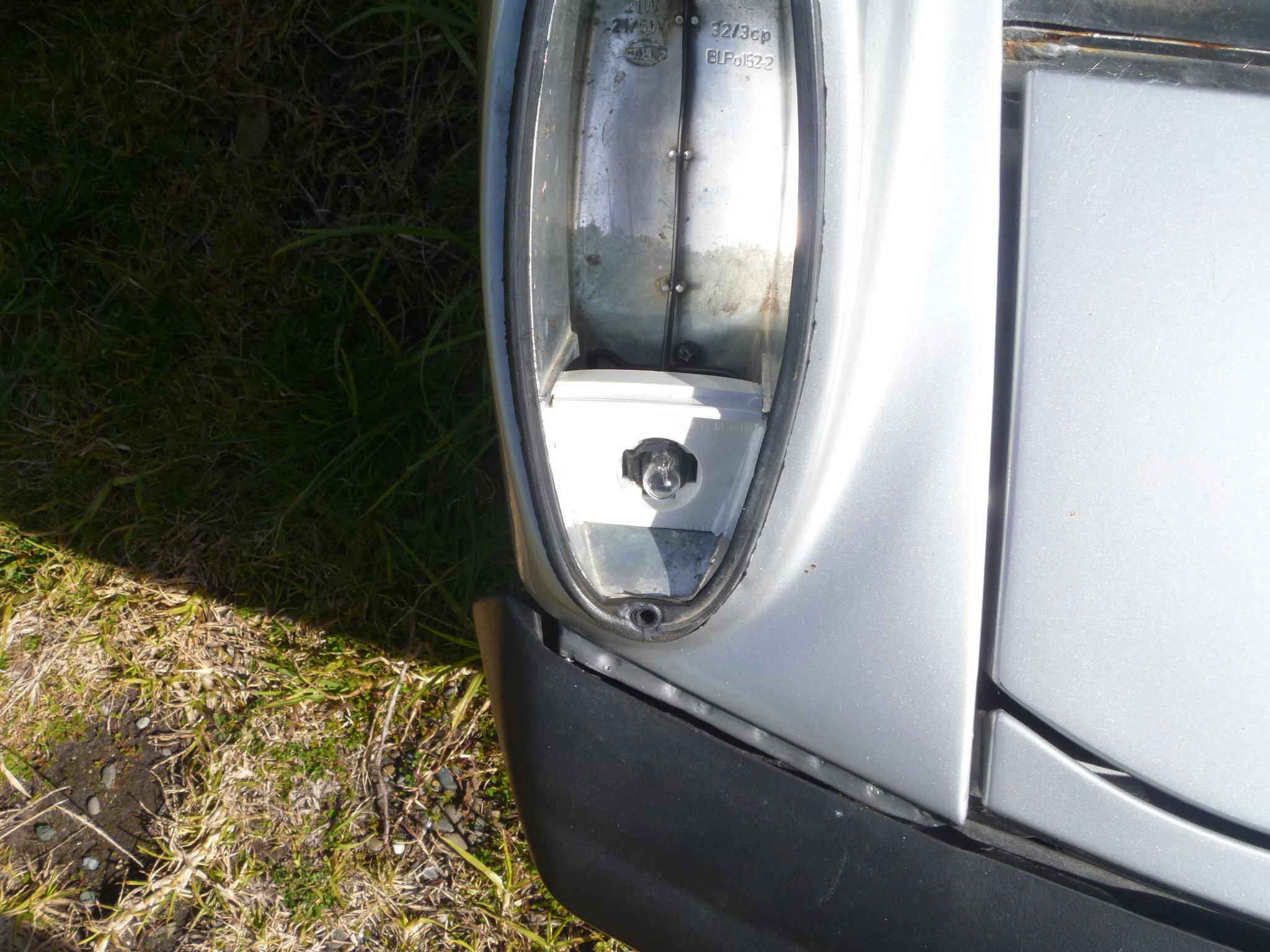

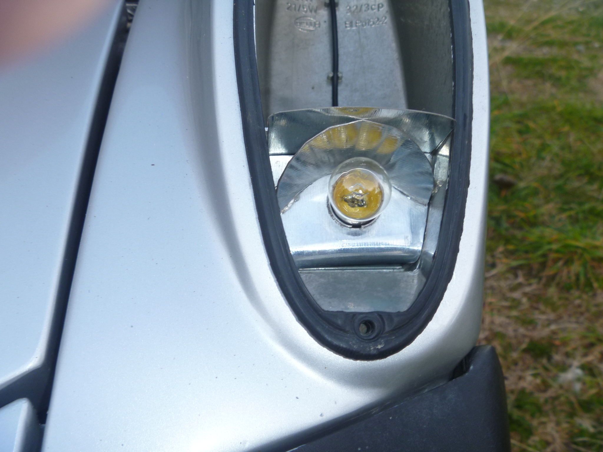

Hi ,not much of a kit really, better around,found lamp weak and lamp holder rubbish and a really poor fit from a chopped up plastic part from Taiwan,wiring isn't great also,ditched mine and bought from a vendor on here ......the different was night and day.
Anyway its didn't cost much but you get what you get,2 supplies do these really they are a joke,like me you have imported to oversea's and you perhaps have found out.
And afterAttached Image
Good luck being happy with them because I wasn't,my replacements were shipped fast and they work,cheers.
